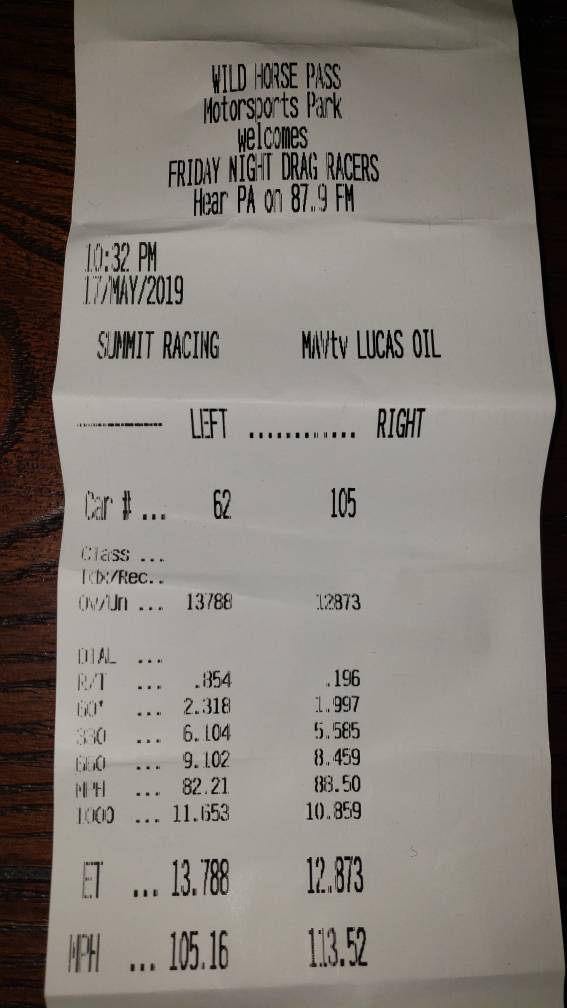

I took it to the track a few weeks back and ran a 12.8 @ 113 mph. It has been about 12 years since I've ran & need to work on my launch, but overall it felt great!

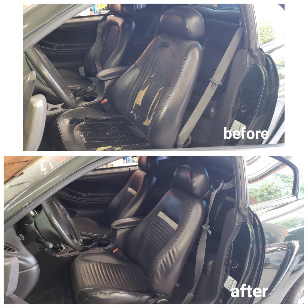

I also have swapped out the stock Bullitt interior which was tore up with a nice set out of a 03 Mach 1.
