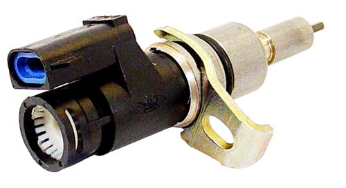

    This is your sensor
    http://www.latemodelrestoration.com/item/LRS-9731A/94-98-Mustang-Speed-Sensor
    [​IMG]

    That is not the sensor I pulled out of the car..... Mine looked like the one on the right in this pic:
    [​IMG]

    That is what I found out. Which would lead you to believe I have a different trans. But, when I looked into it, it was in fact the factory trans. So, what gives?
    So weird. This has not been the first time this car has baffled me. Worst thing about not knowing a lot of its history. Have to sort it out, and sometimes you just can't. Can't figure out the speedometer and why it is off.
    Correct me if I am wrong, but a speedcal fixes a gear ratio or different wheels right? If mine is stock in wheel diameter and stock gears with no speedcal shouldn't the speedo be correct?? So that should mean that the wires that go to the speedcal from the sensor is causing the speedo to be off, right? I left the wires from the ERA in to ease installation of the new speedcal. Maybe I should just remove the wires and see what happens?

    What makes you think thats the right trans? And not out of a car thats a year newer. I'm guessing the new style sensor has a different output cal, similar to how my 99 t5 was initially reading 4-5x higher than GPS speed.

    Just saw online that 99+ uses an OSS speed signal, as opposed to a VSS. I believe thats the scenario I encountered with my 99 T5 transmission. A speedcal will correct it to the VSS signal that your car expects to see. Post up what colors the old speed cal box was wired to, maybe a pic or two. I'll do the best I can to help, hope it gets straightened around. The TOB sounds like its seen better days.
