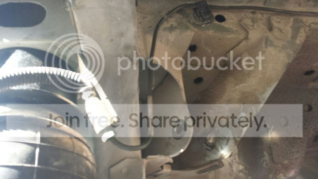

Brake lines finished.. bought a new line at autozone. 3/16 brake with metric m10 x 1 fittings with a bubble flare. I also bought a 3/16 T for double flares with matching fittings.. you can not use a double flare on a bubble flare.. I bent my lines to run out of the way off the it's control arm and meet a lil off center on the pass side.. I cut the metric fitting off the main feed line coming from the master. . I used one of the new double flare fitting on it.. then I cut the new line to where it would meet the T and flared another fitting on there same thing with the other side. . I used a double flare T instead of the bubble flare because it's easier to find. And is cheap.. the double flare will hold pressure just as good as the bubble flare..
