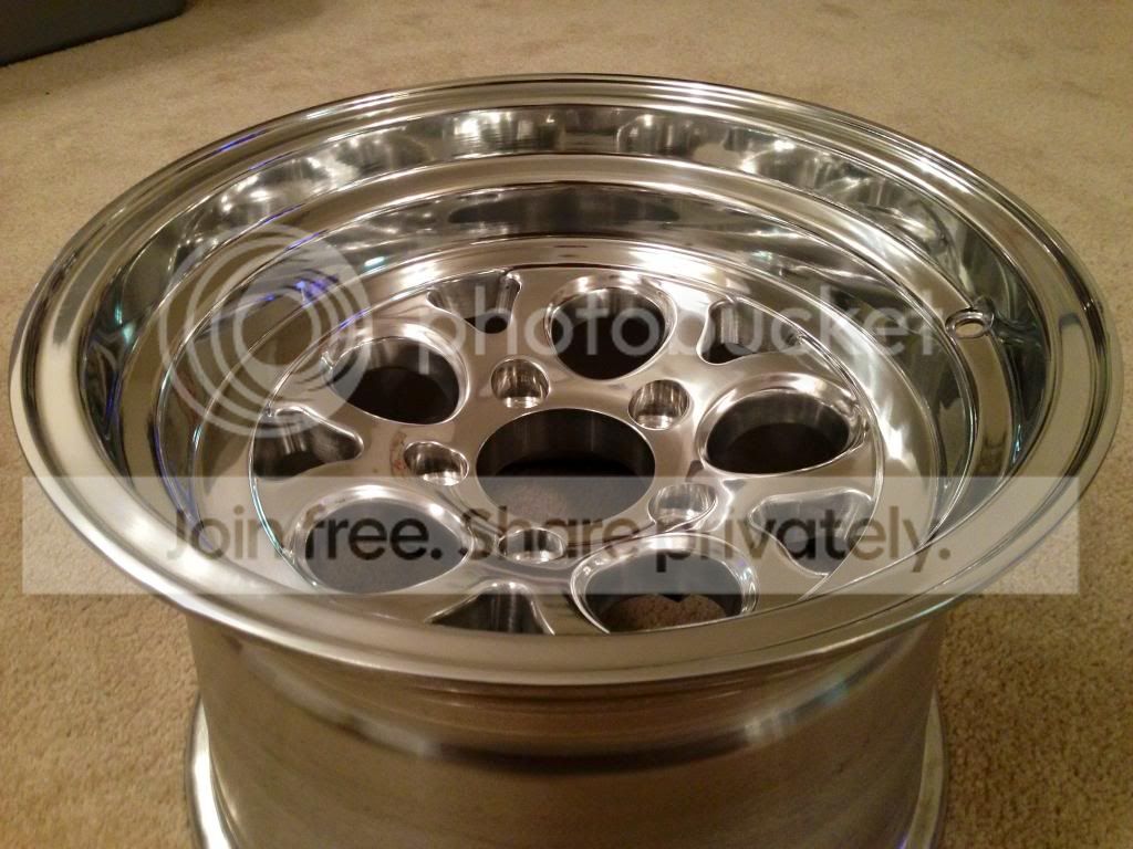

Feb 3, 2014 #1 Wichers123 Well-Known Member Joined Apr 21, 2013 Messages 1,203 Reaction score 0 Location Covington, louisiana Okay guys I'm gonna be ordering a set of summit drag thrust wheels for my car but I need to know the back space to run on a 15x10. I'm gonna be running a 26" tall tire.

Feb 3, 2014 #2 slow90coupe Well-Known Member Joined Jan 3, 2012 Messages 1,969 Reaction score 105 Location Advance, NC 6.5 backspacing will be perfect.
Feb 3, 2014 #3 OP OP Wichers123 Well-Known Member Joined Apr 21, 2013 Messages 1,203 Reaction score 0 Location Covington, louisiana They don't offer but 5.5 or 4.5
Feb 3, 2014 #4 Addermk2 Well-Known Member Joined Mar 7, 2006 Messages 2,534 Reaction score 55 6.5" sucks, doesn't it. The good stuff never comes in the right size.
Feb 4, 2014 #5 OP OP Wichers123 Well-Known Member Joined Apr 21, 2013 Messages 1,203 Reaction score 0 Location Covington, louisiana Well I did alittle measuring and found that my 17x9.5 wheels have a 4.5" backspace. So that tells me a 5.5 should work just fine.
Feb 9, 2014 #6 OP OP Wichers123 Well-Known Member Joined Apr 21, 2013 Messages 1,203 Reaction score 0 Location Covington, louisiana Yep so it wasn't gonna work. Now summit sells a centerline rev wheel that has a 15x10 with a 7" backspacing. Will this work?
Feb 9, 2014 #7 Addermk2 Well-Known Member Joined Mar 7, 2006 Messages 2,534 Reaction score 55 gonna want to run a .5" spacer.
Feb 9, 2014 #8 OP OP Wichers123 Well-Known Member Joined Apr 21, 2013 Messages 1,203 Reaction score 0 Location Covington, louisiana ? Where will it rub. And also what about the fronts?
Feb 9, 2014 #9 Addermk2 Well-Known Member Joined Mar 7, 2006 Messages 2,534 Reaction score 55 depending on the size tire you run, a 7" B/S wheel could hit on the inside wheel well.
Feb 9, 2014 #10 duff daddy Legend Joined Jun 29, 2008 Messages 8,228 Reaction score 18 Location Boston Yea typically if you run a 10 you will run a 6.5 if avail
