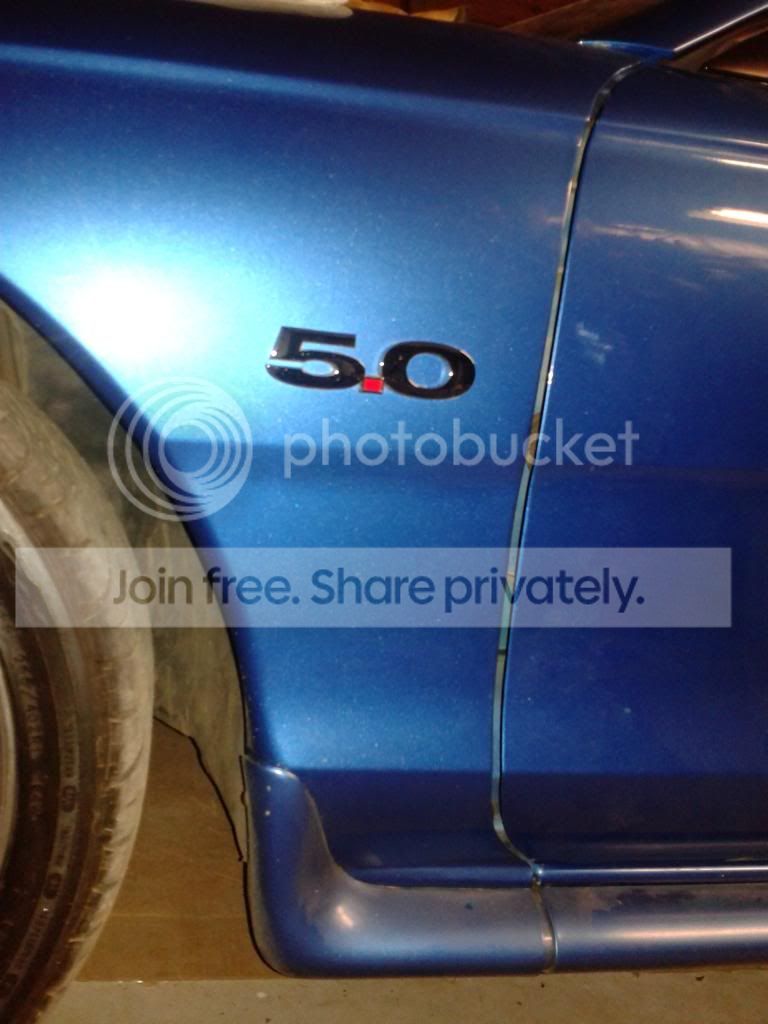

Sorry this is late, this is what I ended up doing and hopefully this will help you out.
Factory Coyote 5.0 badges from Ford.
I cut the pins with wire cutters and sanded them down deeper than the decal tape.
Used painters tape around the badge. Got some fishing line and went behind the badge doing a side to side motion.
Used a sharpie to mark the placement of old badges. Used "Goo Gone" to remove the adhesive on the fender. (making sure not to get it on the paint)
Removed the blue film protecting the decal tape & the number 5 covers up the factory hole. :thumbsup:

Thanks Will. That helps a lot. Nice pics.
