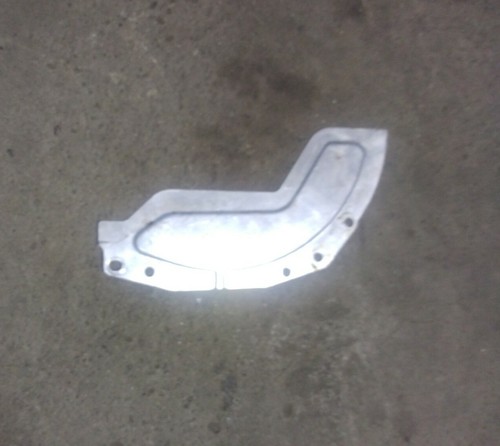

Is there supposed to be a cover on the lower bell housing opening?

Been a while since I've been under a Mustang.
Isn't there supposed to be a cover on the bell housing?

CJPonyparts sells reproductions.

That doesn't seem to match the shape of the lower cutout of the existing separator plate on mine though. I'll have to crawl under there and get some better pictures. Wish I had a lift.

Looks like the inspection cover has been missing for a long time. Might find one in a salvage yard. Check 90's F-150's with aode or maybe 4r70w. Possible older v-8 vans, or t-birds, cougars, etc.

Anyone know the correct size bolts to use to hold it in place? Google search makes me think 8mm?

Those look to be the correct shape. The link I posted was for the modular stuff. I am not sure on the bolt size. I think the modular stuff uses m10x1.5 bolts.

That looks like the correct cover, I would make one before paying out that kind of money. I believe 8mm is the correct bolt size, about 3/4" in length.
If you can wait a day or 2, I will pull mine off and post the cover size and bolt info.

I placed the cover on a 1" 'grid' board, unfortunately didn't orient it properly, but think you get the idea of the size. Mic's at 042, very light weight, so it must be aluminum.
We were both wrong on the bolt size. Actual is m10-1.5x40mm o/l, flanged hex head.

I ordered on off of ebay, and they gave it to me for free if I confirm it works on 94/95.
I also ordered one with hardware from a guy on another mustang forum.
