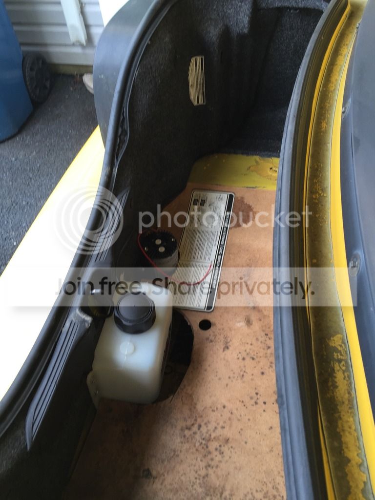

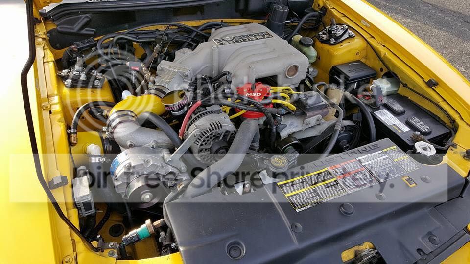

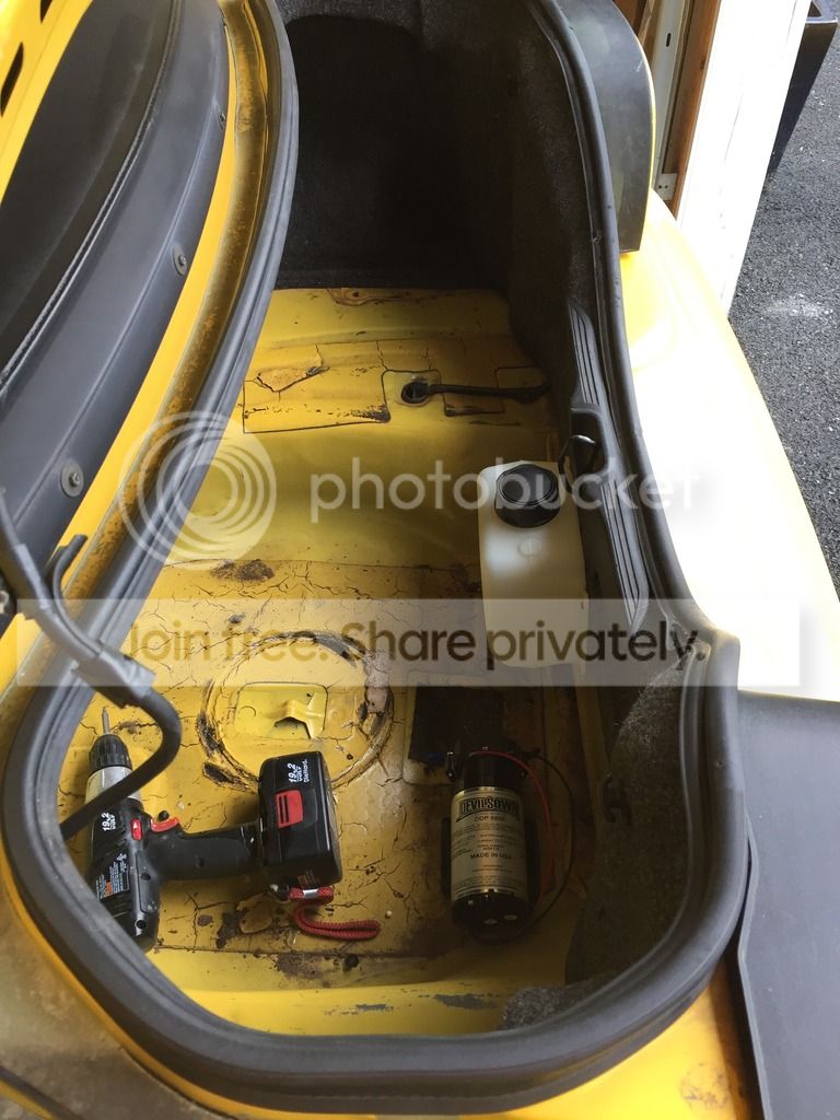

So I decided to look into Methanol Injection as I hear great things with this, but never got into it before because I always had intercooled setups before. Well, fast forward to a few weeks ago, we got back on the dyno to check results and the first pull with a 275ml nozzle and NO TUNE adjustment, shot from 372whp to 430whp!!!! I thought the tuner made a mistake, but made another run to back it up. He didnt think meth was flowing as he saw no enrichment, but I knew it was. We saw the IAT's drop to below 100* under boost and basically the car autotuned itself and added the missing timing back in. We played around with it a little more and ended up with a 975ML nozzle and made 453/436 on a 3.33" pulley (stock pulley) . I was happy with this and didnt want to cram much more into it, so we left it on the safer side considering and I rolled out with my new beast.
So now to today, a little under 2 years later, I have only put a couple thousand miles on her as it is a toy for me, but I have over doubled the HP and she handles pretty decent and looks good too.

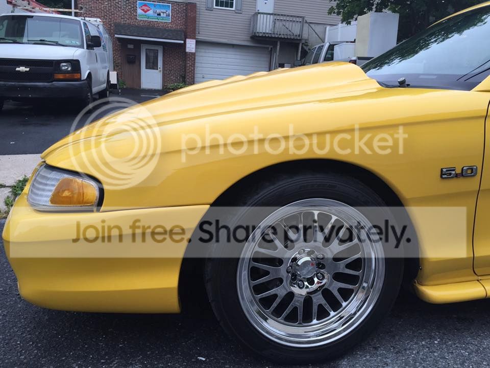

Appearance:
Boss Inc Y2K Cobra R hood
Kaenen Saleen S281 Spoiler
OEM Cobra Headlights
CDC Styling Bar

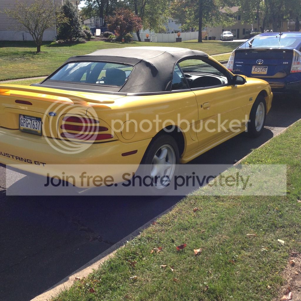

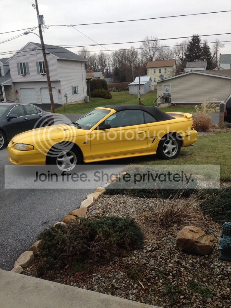

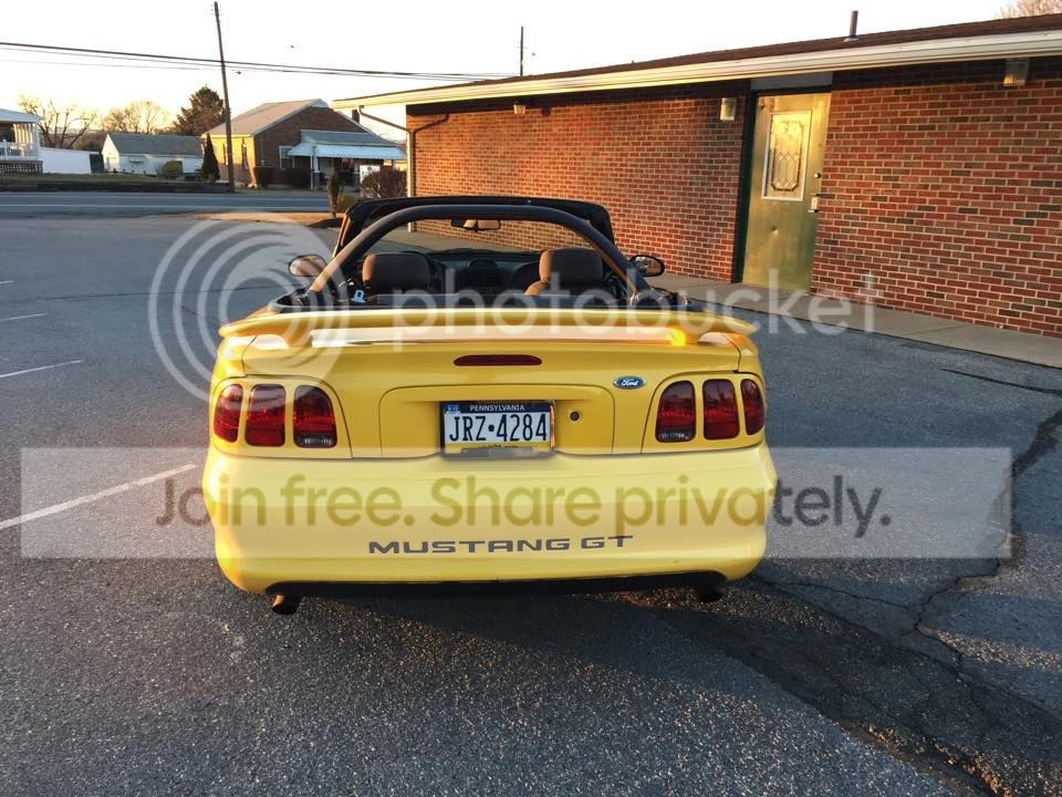

Here is my trip to go look at it before putting a deposit on it
Here is at the Notary taking delivery of the ole girl
Here is once she is home in her original 20 yr old glory before I started messing with her

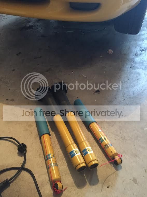

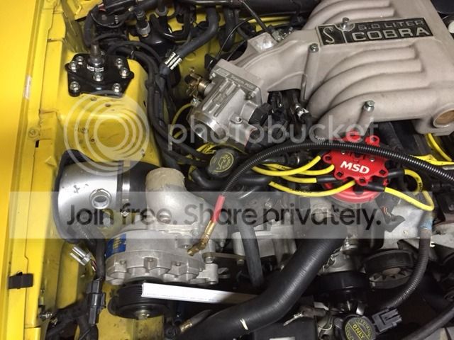

Here are some pics of the first setup I went with before things got serious
