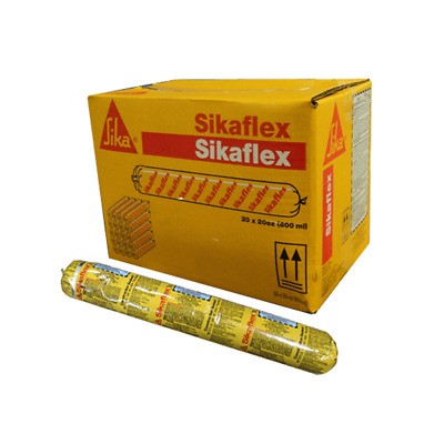

I had to cut the top of my tunnel out and build a new piece about 1" tall to get my TKO600 in to my car and keep the yoke angle right and not hitting the trans. The tunnel was double walled in spots ? My Cobra is factory stick . That trans is now in an 86 Fox,,,went right in . Hemm?? I have not seen or heard of anybody else that has done this??? for what its worth the (in my opinion) right way to seal this up is an industrial sealant called NP1. its made of butyl rubber , I think, and is Very similar to the seal sealer they used at the factory. Its increasable stuff. I find it at a concrete/masonry supply house.

Thanks for the tip on the sealer. Right now it is pulled against the peel and stick that’s on the floor and it should seal up ok. I’ll keep your recommendation in mind for when I pull this out to seal it up better.
