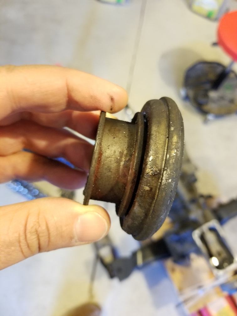

So the chirping came back just before I parked her for the winter. Now that Spring has sprung i decided to take her apart to replace the throwout bearing and rear main seal. Remind me not to do it again! What a pain working on your back.
Anyway, now that it is apart i see a few concerning things.
Number one is the condition of the sleeve the throwout bearing rides on. It has grooves and ridges worn on it. Is this an easy to change part or can I just clean it up and reuse?
Throwout bearing is still in one piece but has a lot of play in it and does not spin smooth and quiet. Not sure it is stock as it looks like a timken design. No part numbers on it to verify but pics below.
I see wear on the pivot ball and pivot point on the clutch fork so I think it needs to be replaced.
Clutch disc itself looks fine but there are three spots on both the flywheel and pressure plate that could indicate an issue. I'm thinking to replace both the flywheel and clutch.

I wonder if your initial issue with the Luk clutch was just a clutch cable adjustment issue. Hard to imagine refinishing a flywheel would be enough to cause a problem. I went with a new Luk flywheel since it was similar price to getting the stock one resurfaced. New valeo clutch assembly and ford performance throwout bearing as well. Funny thing is, the valeo kit came with what appeared to be the same bearing. Looked identical. The only difference is it came in an unmarked box where the Ford bearing came in an identical box but with the Ford label on the side I also changed out the damaged bearing retainer sleeve with the steel Ford performance part. Felt good to do it myself but I'm not sure I would do it again. Just too much of a pain working under the car without a hoist and there was a couple times an extra pair of hands would have helped a lot. End result is a smooth operating clutch that feels a little lighter and a little more progressive than before. Still not beating on it until the break in period is over (500 miles).
