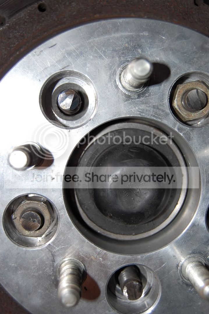

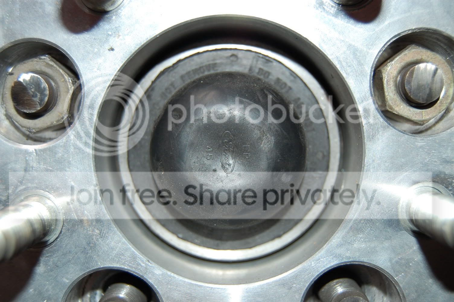

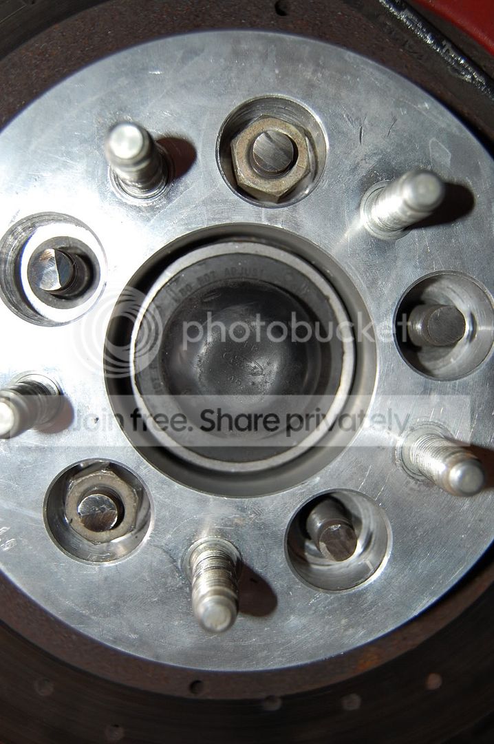

So I bought some spacers to bolt on my 15x3 draglites and clear my 13" cobra brakes. Went w/ 1.25" hubcentric. Had to grind down my stock wheel studs slightly to sit flush w/ the spacer so no big deal there. However it doesn't sit snug over the hub. When I have the spacer bolted down I have a 1/16 gap around the entire hub so basically the spacer doesn't sit on the hub (I don't think that should be) since I thought the point was to have the weight of the car taken by the hub. Although it's a small gap it seems to me it's not serving any purpose since the spacer is not resting on the hub. Anyone else have spacers that fit like that or are these wrong? I'm only using these for when I got to the track but I shure as hell don't want my freakin wheels falling off. Here's what I got. :angry4:

yea, I know they aren't mustang specific or anything like that. I'd imagine most are a universal fit. I remember a few year back a kid w/ a mustang had the spacers break and lost his damn wheel on the highway so I just have that stuck in the back of my head. I'll be the first to admit, I absolutely hate the idea of running a spacer on any wheel. What sucks is that I already installed them so I'm stuck w/ them regardless and would hate to buy another set on top of already having these.
here's some pics

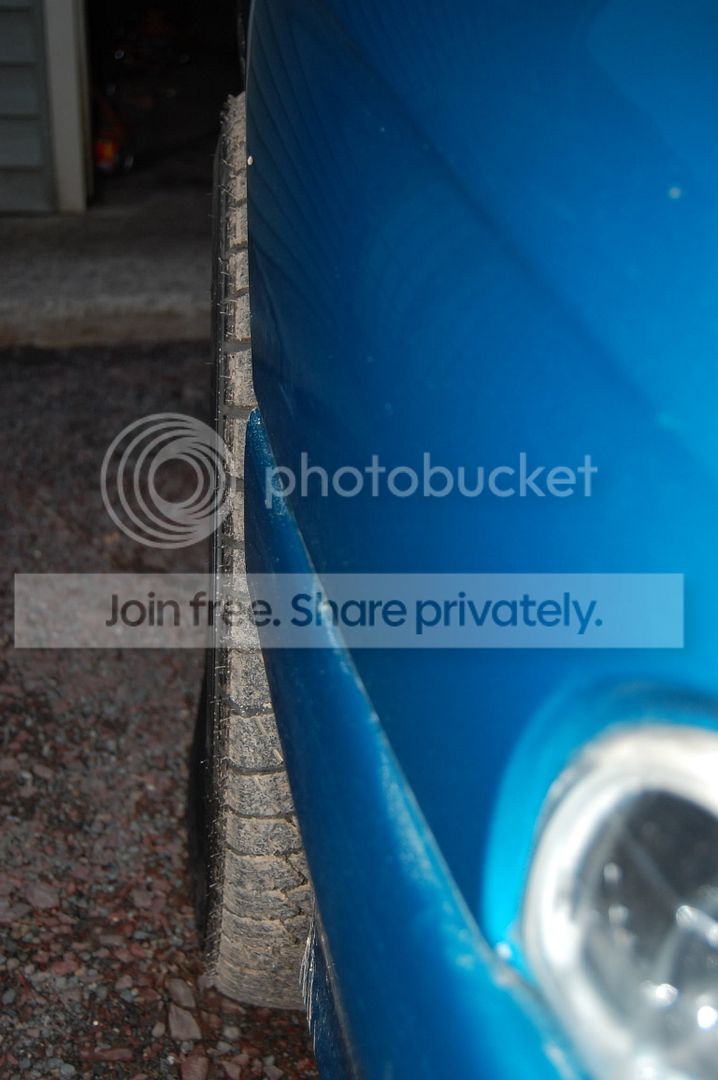

doesnt that make your wheel stick out really far? Pics when you get it one please. Mine stick out and i just run a spacer to clear my stock brakes.

They do stick out but not too bad imo. I'll snap a pic tomorrow (need to pick up some different metric lugs) I'm only going to use them at the track so I'd be able to live w/ the crappy spacing as long as they stay on.

did you use the same brand spacer matt? I just want to make sure these are right before I decide to race the car w/ them. It's at the most 1/8" gap around the hub (maybe even less).

I have H&R 1" hubcentric spacers and they sit snug around the hub.
ArkansasMystic
Dec 7, 2008
90
Guys, I could be wrong, but from what I've been told those spacers in the ebay link ARE NOT hubcentric. I was told to be hubcentric they must have the lip on the outside. Take a look at these:
http://www.stangsuspension.com/store/comersus_viewitem.asp?idproduct=169
See the lip on the outside? The ones on the ebay link don't (unless their pics aren't accurate). Correct me if I'm wrong, but that's the way it was explained to me. I've got a set identical to those in the ebay link but I'm scared to use them because I was told they are lug centric.

hmmm. mine aren't snug on the hub. I couldn't use the H&R w/ my draglites due to that lip, they are flat on the back. If the lip was there my wheel wouldn't sit flush.

bolted them on today and went for a drive. They seem fine up to 100mph so I'll guess they'll work out.
droptop here' the pic you wanted
