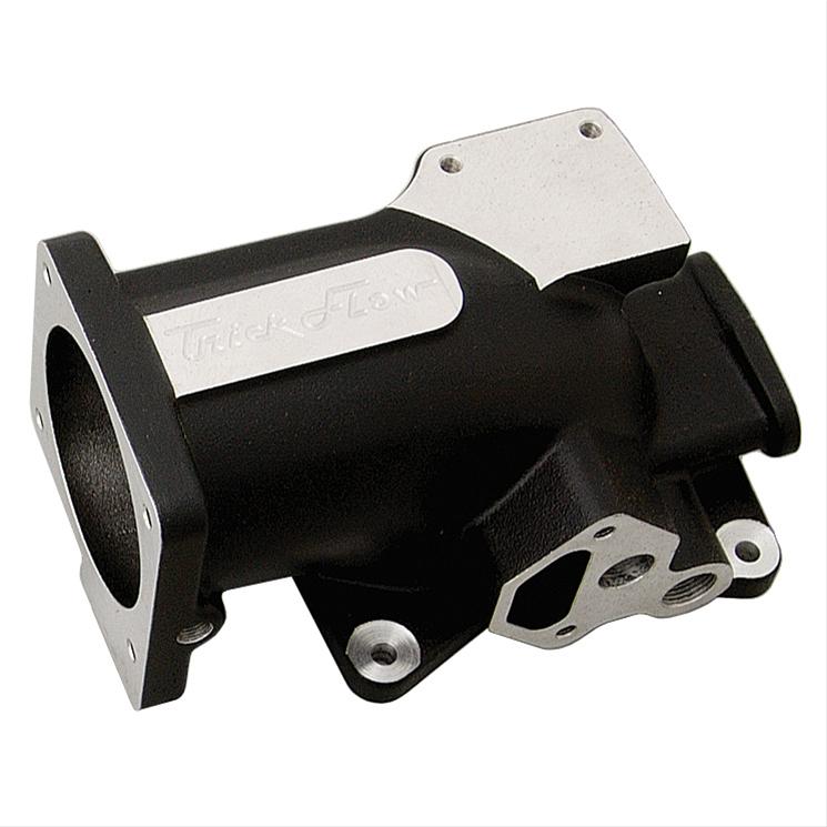

I am considering installing the following:
JLT Intake
BBK Throttle Body
Trick Flow High Flow Upper Plenum
The motivation would be a little better sound, a little better throttle response, better look under the hood, and maybe a few HPs. I have estimated these 3 mods would cost about $600-$700 if I did them at same time. I am not under any unrealistic impression this would give me some huge performance boost.
I'd like to hear opinions on how much this would help sound. Also, does this sound feasible? And again, I am aware this would not be a giant performance gain without doing a lot more. Thank you!

Here are the 3 links to parts. I should have included for price and spec purposes.
Thabk you for all that contributed. Still researching.

I’m probably in the minority here but I wouldn’t pay that much for a throttle body. I’ve used two no brand 75mm throttle bodies for years without issues.
I’d look high and low for a plenum for the least amount of money as possible. They all give similar gains but the prices are all over the place. And the thing is they won’t net you much, so I personally can’t justify paying a couple hundred bucks for 5hp.
Same goes for the cai but the prices are crazier than plenums are.

Mid pipe will help like stated. I have a bank o/r pipe and to me it’s to raspy, then again I have stock mufflers on the car still.. some long tubes headers would definitely wake it up but they are a challenge. As far as bolt one you really won’t notice much difference. I’d say get a crown Vic plenum.

+1 with the ugly vic plenum. Sure its ugly but its a cheap upgrade. Score a 70mm truck 5.4l throttle body, swap the butteryfly bracket and then youll have a cheap throttle body upgrade
