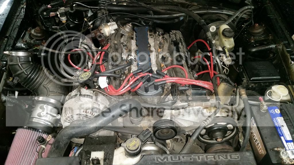

Changed the sparkplug wires with a brand new Ford Racing set today, didn't seem to do much improvement to be honest. Car still has a horrible idle to it. Pulled the codes with the engine shut off (KOEO) for a second time and it seems to be giving a bunch of codes... I would appreciate if someone could chime in and read them for me... thanks !
[video=youtube;gawlsorf3M8]https://www.youtube.com/watch?v=gawlsorf3M8[/video]
Cylinder balance test results
1st pass : 2, 5, 7
2nd pass : 8
3rd pass : 9

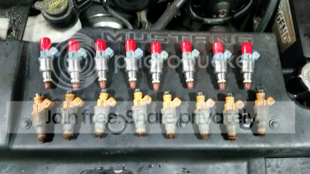

Just wanted to tell everyone that the problem has finally been resolved ! The car is running like a champ, better than it ever did... Just as everyone suspected on this thread the issue was within the C&L housing and the reason why is because the mass calibration sample tube inside was calibrated for 24lbs injectors not for the stock 19lbs ones ... I did not even know you could swap the sample tube inside. I could've bought and swapped the correct sample tube (two allen screw) but I had a killer deal on a set of Ford Racing 24lbs injectors from a Cobra. I swapped the injectors in tonight and the car is an absolute joy to drive around now... I'm glad I did, some of the o-rings on the stock injectors had needle holes in and you could tell a few were worn. I would like to thank everyone who tried to help me, I know that I'm stubborn but in the end all is good, I got to know my car better and fixed all sort of little issues. Hopefuly this thread might help someone in the future too who knows ?
