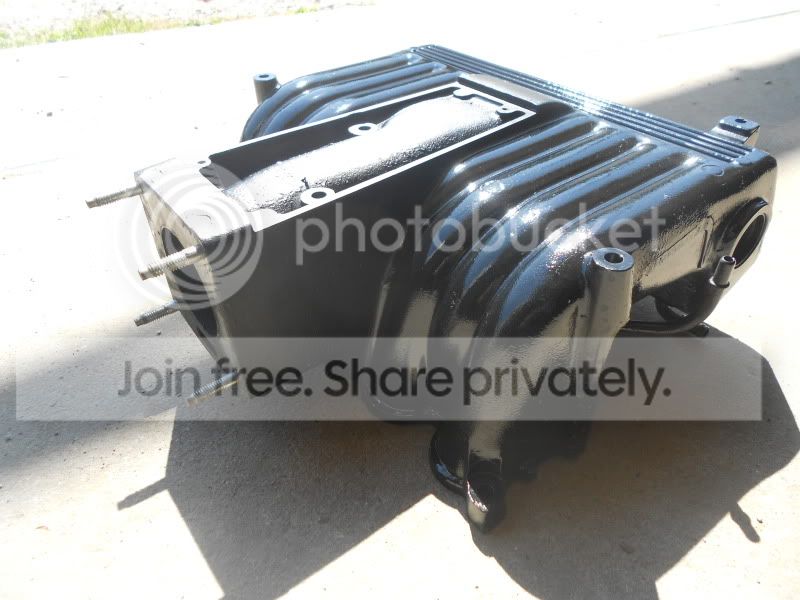

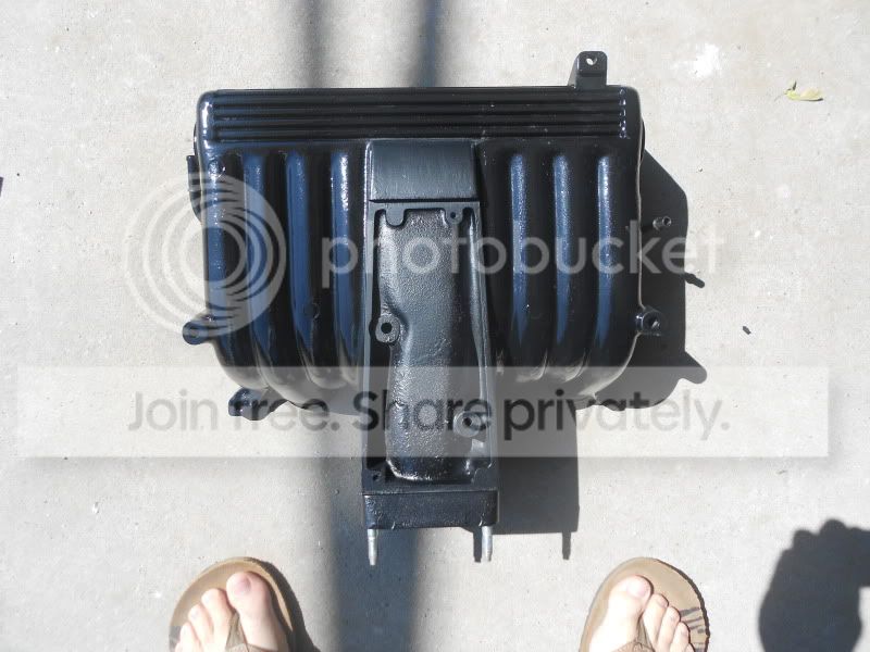

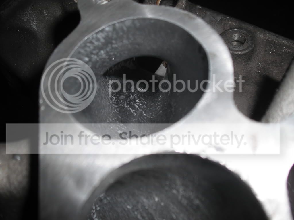

<blockquote data-quote="Raffaelli" data-source="post: 1002942" data-attributes="member: 12402"><p>Have fun porting the intake, just make sure you have the right tools.</p><p></p><p> Not really anything hard about it, except that dog legged runner (#1 I think). I built it up alot with JB Weld epoxy and then ported the snot out of it. The rest are easy though.</p><p></p><p> <img src="http://i1012.photobucket.com/albums/af244/raffaelli_photos/Stang/DSCF0463.jpg" alt="" class="fr-fic fr-dii fr-draggable " style="" /></p><p> <img src="http://i1012.photobucket.com/albums/af244/raffaelli_photos/Stang/DSCF0462.jpg" alt="" class="fr-fic fr-dii fr-draggable " style="" /></p><p> <img src="http://i1012.photobucket.com/albums/af244/raffaelli_photos/Stang/DSCF0457.jpg" alt="" class="fr-fic fr-dii fr-draggable " style="" /></p></blockquote><p></p>
