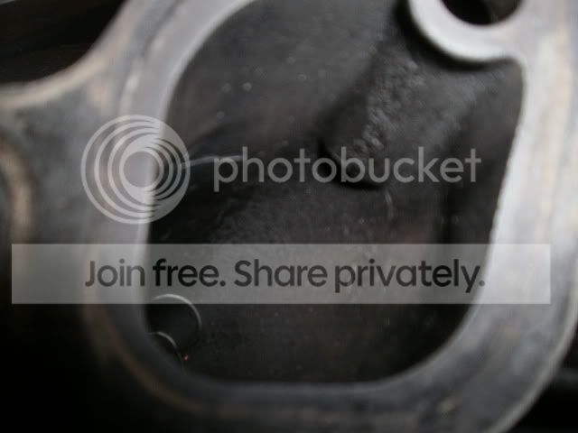

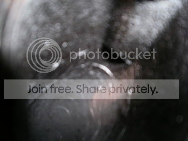

<blockquote data-quote="MustangChris" data-source="post: 829601" data-attributes="member: 10830"><p>the black junk is the exhaust recirculation. it is normal. you can clean it, but in 30 minutes, it will be black again.</p><p></p><p>as for the "problems" it appears to be fromt he casting process. Unless those are *cracks* i wouldnt worry about it. Some people purposely "rough up" their intake manifolds on N/A cars to add turbulance to the air entering the engine. The more turbulant air *supposidly* makes the air and fuel mix more efficiently.</p></blockquote><p></p>
