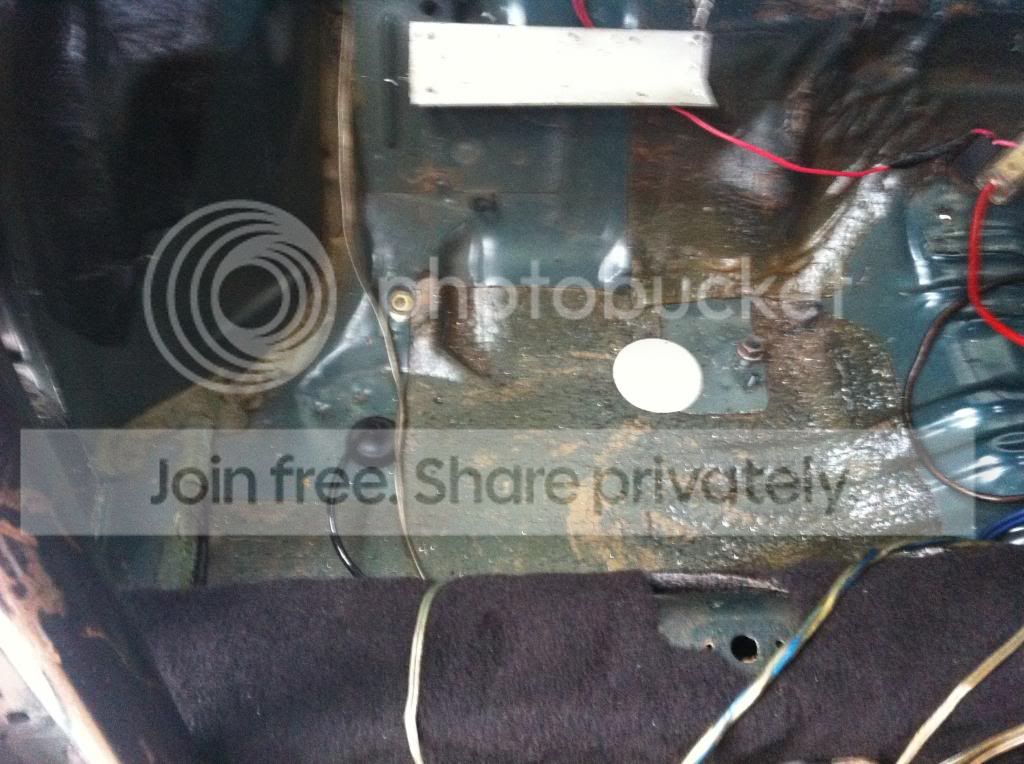

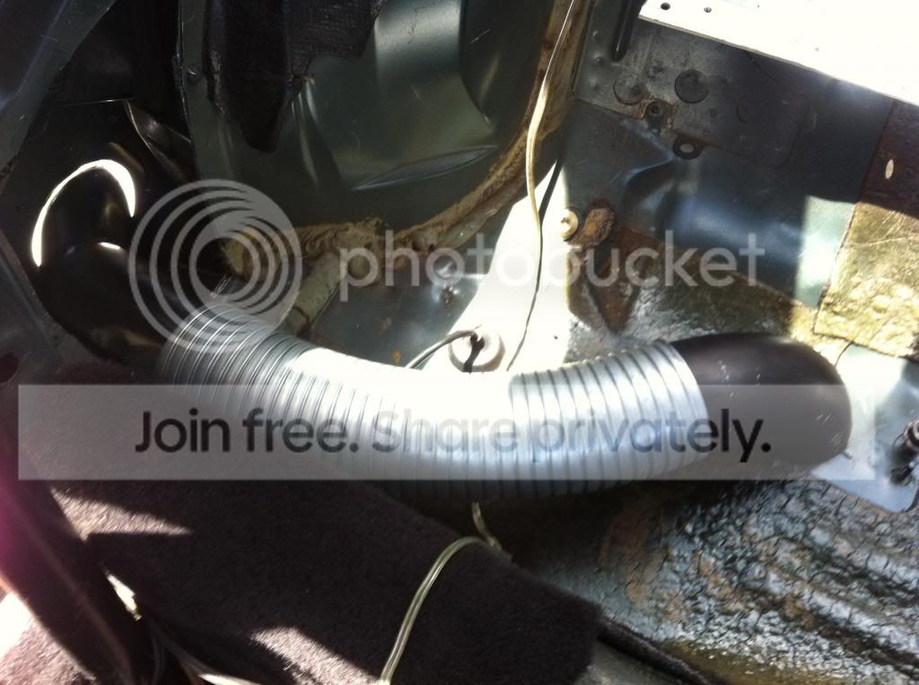

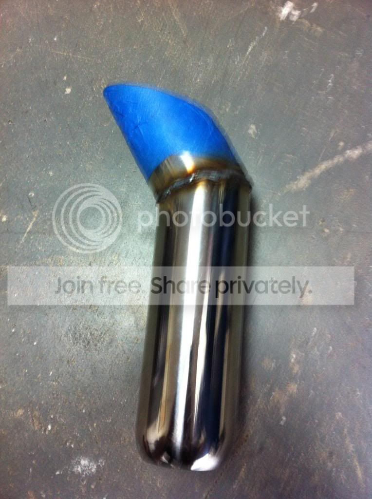

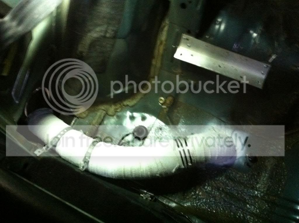

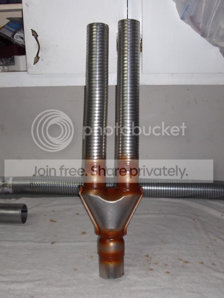

I'll just paste it here from another site I posted it on.
I've always wanted to have that race car side exhaust on my car. I once thought about getting boom tubes, the ones Nascars use that are square. Problem was my full length subframe connectors would push that pipe down even further to the ground and would not look right. It needed to be tight up against the body. Other option would be to run it up inside the car. Lot of work and planning involved in that so it never got done, until today.
I thought about it for months on how it should look and so I bought pieces here and there. The hardest part is doing all this in my driveway. Even though this was months of planning it took me about 24 hours of work to finish. I decided to run both exhaust pipes that are 2.5" into one 3.5". This would result in less time and money. Also remember this is a straight through type of system. The mufflers are Magnaflow race units that have no baffles. Pretty much straight pipes so there is no concern about restrictions. All the turns in the system were done with 90 degree mandrel bent pipe that I chopped up in any way I needed.
The plate on the outside of the car is polished SS. The exhaust tip is also polished SS. The plate is held in place with SS rivets. I must mention that most of the system is welded together but I did set it up in a way that it can be taken apart easily for service to it or the car.

That's pretty sweet dude :) Good work.
Edit: more work, and would cost more in parts, but thought I should mention it: if others want a side exit on each side, they could run smaller pipe up on each side and then turn it out right in front of the wheels, rather than "Y"-ing it into one pipe. I like what you did here.
