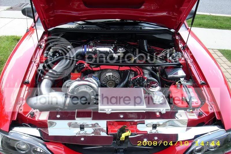

<blockquote data-quote="97stanger" data-source="post: 543737" data-attributes="member: 8229"><p>Well I run a vortech, but this will help regardless of the setup. I had to ditch my stock strut tower brace because the discharge tube was hitting, so I went with a Steeda STB. Didnt help at all. Ditched that and went for a Maximum Motorsports, and plenty of clearance. So conclusion=MM has more clearance. Hope that helps:</p><p></p><p><img src="http://i48.photobucket.com/albums/f247/michael97stang/MustangPicsJuly1.jpg" alt="" class="fr-fic fr-dii fr-draggable " style="" /></p></blockquote><p></p>
