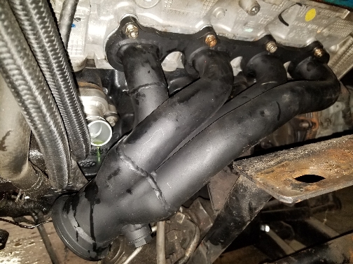

Thanks for the picture. I'm aware the factory ones are like that but I believe it will touch the hotside which Is why i went with an aftermarket and why they chose to not have it face the radiator is beyond me. I think i have a picture in my turbo install thread. I'll edit this if I do.
I wouldn't be opposed to having something welded. It may turn out to be my best option.

Heres a picture of what I'm talking about.
That entire area has since been wrapped for heat.
