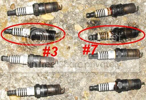

Got home.... found the problem.... The rubber piece on the end of the line from the PCV valve had split completely in half. Went to the local LKQ, got a replacement piece, and now it cranks right up. Haven't tried driving it or anything yet, so I don't know if the misfire is still occurring or not.

I am now done with doing the plugs, took the car for a drive, and HOLY s***! Its like night and day.... The acceleration is drastically different, as well as no codes thrown yet (knock on wood). Now I need to do the wires.....

Btw, here's what my plugs looked like when I pulled them.... Now I know why I was misfiring..... I'm surprised it ran as good as it did....
Apparently, when I changed my intake, I didn't clean up all the fluids like I thought I did.... #3 & #7 had fluid sitting down around them.....
