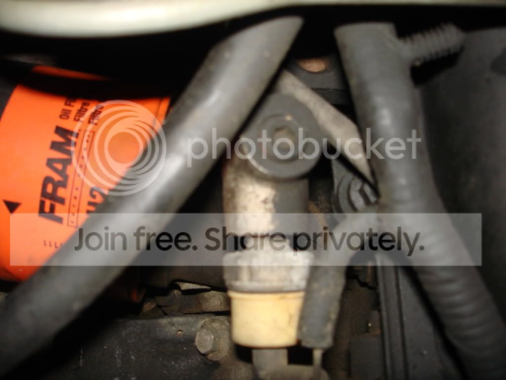

<blockquote data-quote="MustangMatt96GT" data-source="post: 202441" data-attributes="member: 9581"><p>Well i have a short sweep. I just installed it the other day! Actually you dont need a T. In the pictures below, u can see a plug that has an allen head on it. U just take that off and the put in the 1/4 inch fitting that reduces to 1/8 inch. Then you just run your wire up to your gauge pod. Its really easy. Ill include the link that i used to tap my wires for power and evertying a video and those pics!</p><p><a href="http://www.miracerros.com/mustang/gauge.html" target="_blank">http://www.miracerros.com/mustang/gauge.html</a></p><p></p><p><a href="http://s174.photobucket.com/albums/w96/MustangMatt96gt/?action=view&current=MOV03298.flv" target="_blank"><img src="http://i174.photobucket.com/albums/w96/MustangMatt96gt/th_MOV03298.jpg" alt="" class="fr-fic fr-dii fr-draggable " style="" /></a></p><p><img src="http://i174.photobucket.com/albums/w96/MustangMatt96gt/DSC03239.jpg" alt="" class="fr-fic fr-dii fr-draggable " style="" /></p><p><img src="http://i174.photobucket.com/albums/w96/MustangMatt96gt/DSC03238.jpg" alt="" class="fr-fic fr-dii fr-draggable " style="" /></p><p><img src="http://i174.photobucket.com/albums/w96/MustangMatt96gt/DSC03312.jpg" alt="" class="fr-fic fr-dii fr-draggable " style="" /></p></blockquote><p></p>
[QUOTE="MustangMatt96GT, post: 202441, member: 9581"] Well i have a short sweep. I just installed it the other day! Actually you dont need a T. In the pictures below, u can see a plug that has an allen head on it. U just take that off and the put in the 1/4 inch fitting that reduces to 1/8 inch. Then you just run your wire up to your gauge pod. Its really easy. Ill include the link that i used to tap my wires for power and evertying a video and those pics! [url]http://www.miracerros.com/mustang/gauge.html[/url] [URL=http://s174.photobucket.com/albums/w96/MustangMatt96gt/?action=view¤t=MOV03298.flv][IMG]http://i174.photobucket.com/albums/w96/MustangMatt96gt/th_MOV03298.jpg[/img][/URL] [IMG]http://i174.photobucket.com/albums/w96/MustangMatt96gt/DSC03239.jpg[/img] [IMG]http://i174.photobucket.com/albums/w96/MustangMatt96gt/DSC03238.jpg[/img] [IMG]http://i174.photobucket.com/albums/w96/MustangMatt96gt/DSC03312.jpg[/img] [/QUOTE]
