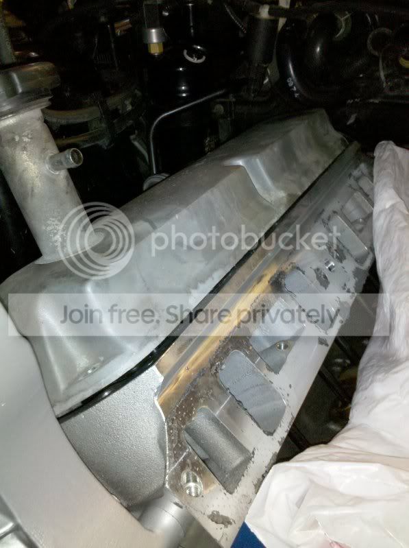

and just to make sure, 90-93 valve covers will clear 1.6 roller rockers on TFS heads?
Did you read the thread? I'm pretty sure my first post has pictures of exactly that.

The last two pictures are of fox valve covers on TFS heads.

i have stock stamped steal valve covers on my car, with trickflow heads, and 1.6 comp magnum rockers, tight fit but they went on and no problems

The way around the filler neck is its in the way of the 94-95 elbow and intake,just buy yourself an extension with a filler neck filter then it will sit right above the intake and easy to change the oil thats what I did I bought one from metco motorsports heres a pic of my engine bay now able to clear stock valve covers aftermarket intake and the filler neck all under a stock hood ;) and it fit ford racing 1.6 rockers trickflow heads and intake, all with stock hood and valve covers, spacers and double thick gaskets and it just made it tight fit ;)

well, I purchased a pair of 93 fox valve covers and they dont fit. theres about a 1/4 inch gap between the valve cover and cylinder head because the valve cover is sitting on the rocker stud on the passenger side. the driver side fits perfect. The baffle has been removed and it still does not fit. what did you guys do to yours to make em fit. this is getting ridiculous...

I made them fit! I used a thick gasket to clear the roller rockers and had to grind off a bit from where the valve cover hits the alternator.
