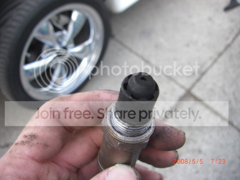

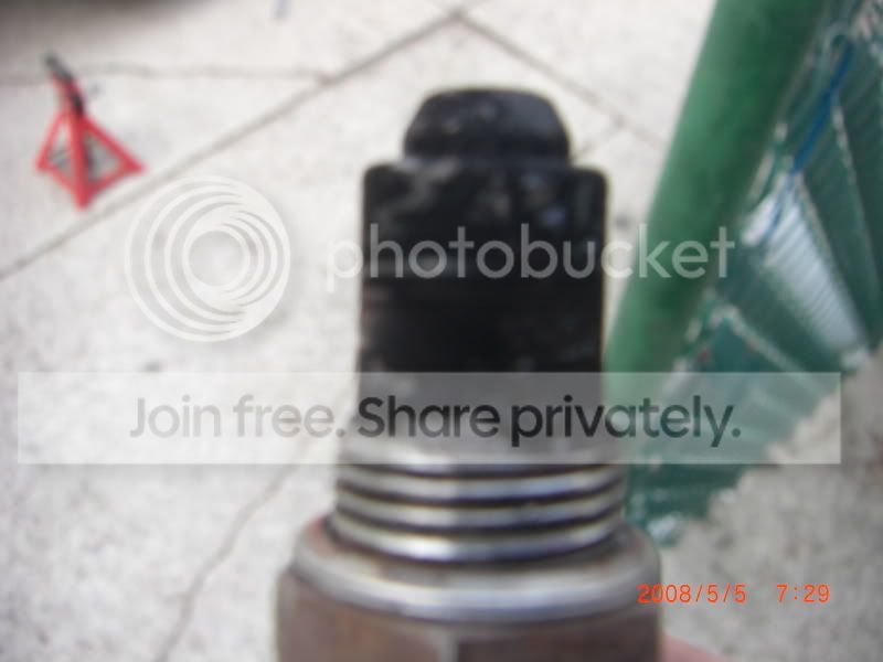

When I removed the rear O2's (the fairly new ones) they were absolutely COVERED in carbon. None of the perforations were clogged or anything, but they had a lot of carbon build up on 'em. Is that an indication of anything important? I already have a sneaking suspicion that my cats are shot, but I'm not worried about that ... I just want the engine running right.
One more interesting thing ... one of the rears looked to have a few drops of some type of liquid on it. I smelled it and didn't really get a strong gas smell or anything, but what else could it have been? When I wiped it off with my finger, it seemed to eat away the carbon and leave everything squeaky clean. :confused:
And FYI the old front O2's seemed to look "normal" considering their age. Nowhere NEAR the carbon build-up that the rears had. Actually, they were virtually carbon-free.
The "macro" setting on my camera wasn't working very well...but here are a couple pics. The fuzzy looking one is the one with the moisture on it ... you can kinda see it if you look closely.
