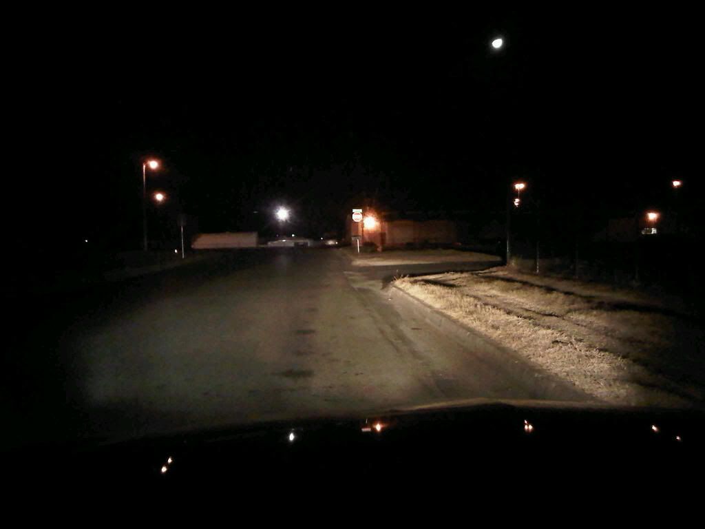

I'm running this setup, did this project last summer. I run the same setup as Riosnake, only difference is my projector setup is different. I pulled the clear lenses off used my smoked lenses from old headlights to not loose the look, but kept the functionality of the car.
27,321
Like this, my Grand prix:
Low beams
High-low beams
now if i can just rewire the foglights to stay on too, ill be good. lol
