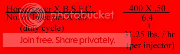

Using these numbers as a guideline, you can select the approximate injector size in the following formula.
For your injectors you wont want to run them over 80% duty cycle and this is the accepted industry standard, though you can run them over 80% duty cycle this will shorten the life cycle of the injectors..
The formula is the following
To find the HP value of the of the above mentioned injectors use this formula:
So you can see that 8 39lb injectors should hold 496 hp, for a n/a car, a supercharged car will need .65 B.S.F.C. and a Turbo car will need .60 B.S.F.C.
