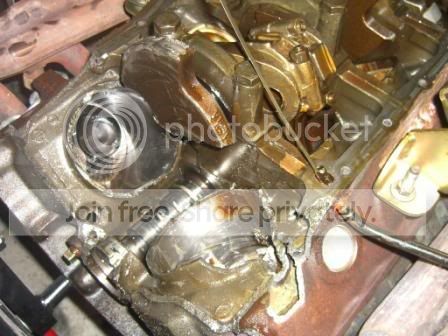

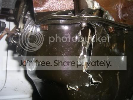

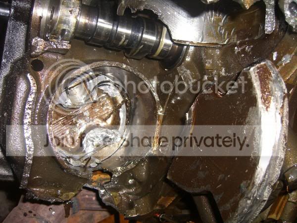

Hmm.. here is my stock cobra bottom end after 6,200 rpms :)

omg to that cobra block, only 6,200 rpms did all that damage? how much stress was being put on that motor? are you sure it wasnt more like 7200 rmps?
birel21y
Dec 17, 2007
559
Thats road racing for you... 4500-6200 constantly for 20-30 min. at a time. Autozone harmonic dampener cracked, and rotated 180* LOL!!!

with a good dampener (sfi) the motor would have still been alive.
birel21y
Dec 17, 2007
559
Exactly. Dont go cheap... our hard lesson learned. We had a ford racing HD, but its a bear to get it to clear the SN95 timing cover/ water pump.
