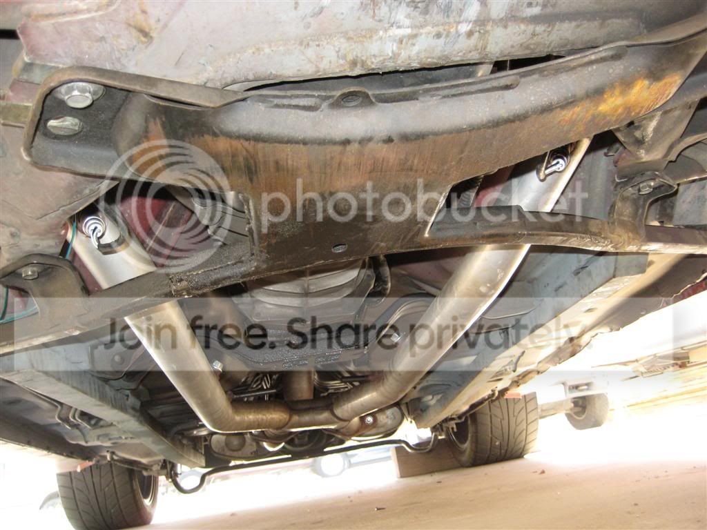

Here's a pic of the 98 pipe on my 97.
the rear o2's point straight at the trans crossmember, and the hangers are way further back.
The pipe didn't hang noticeably lower, as it's still held at the same angle by the exhaust manifolds.
