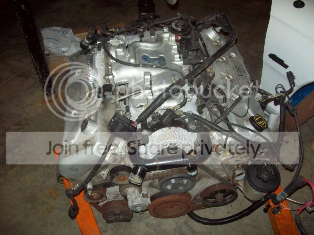

Got the motor today, got started on the tear down. What do I do about the fuel lines? there are 2 lines for the stock motor and a place for only one on the cobra. If im right the second is a return line, right? Do I just cap it off or what? Also, the engine hasn't been started in about a year. I was told I would want to prime the engine(engage the oil pump so everything is lubed) to prevent spinning a bearing. How would i go about doing this? Is it necessary? Thanks for all the help.

When you put the new oil filter on, top it off as much as you can. The engine will build oil presure quickly and it should not be a problem.

Do you have a tuner to turn off the PATS? The ECU wont recognize the key. Also, the wiring to the cluster and the trans mission are different so unless you change everything I imagine it will be a lot harder than you think.
Just use the stock engine harness and ECU. If you want to switch over to the COP design you can try using the stock harness, but the last time I used a 99+ harness on a Early SN it wouldn't stay running. I can only assume it's from the difference in pin placement of the Engine harness connector in the engine bay or the coil wiring.

I have an xcal 2. Whats does PATS mean? I received everything I would need( I was told), I have the ecu, all the wiring on the motor and trans, and two other little boxes. One is located in the passenger side fenderwell. Not sure where the other one is but i'll find it when I get a little further into it.
