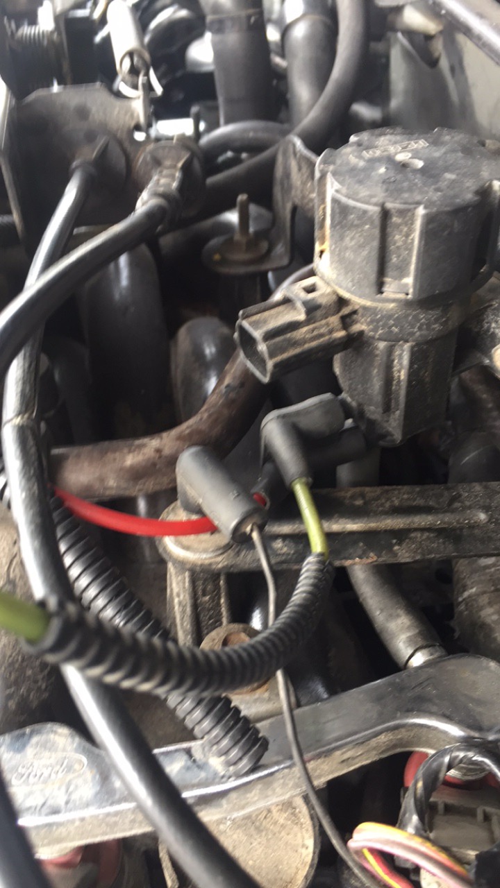

What is the vacuum line in the engine bay attached to? Do you hear a hiss inside the car with the engine running? Make sure the vacuum line going to the ac panel is connected and if you can get to it check for vacuum. Im not sure where the check valve is for these cars but on crown vics there is a check valve under the hood. If its stuck shut it wont allow vacuum to move the actuator. Or it could even be the control panel itself.

d.garza18
d.garza18
Jun 23, 2017
720
159
TEXAS
Everything is in place even inside the car
37,641
7,760
those vac lines look pretty original and I bet there is a leak somewhere else. Try starting it up and spraying some cleaner around the lines and see if the idle changes.

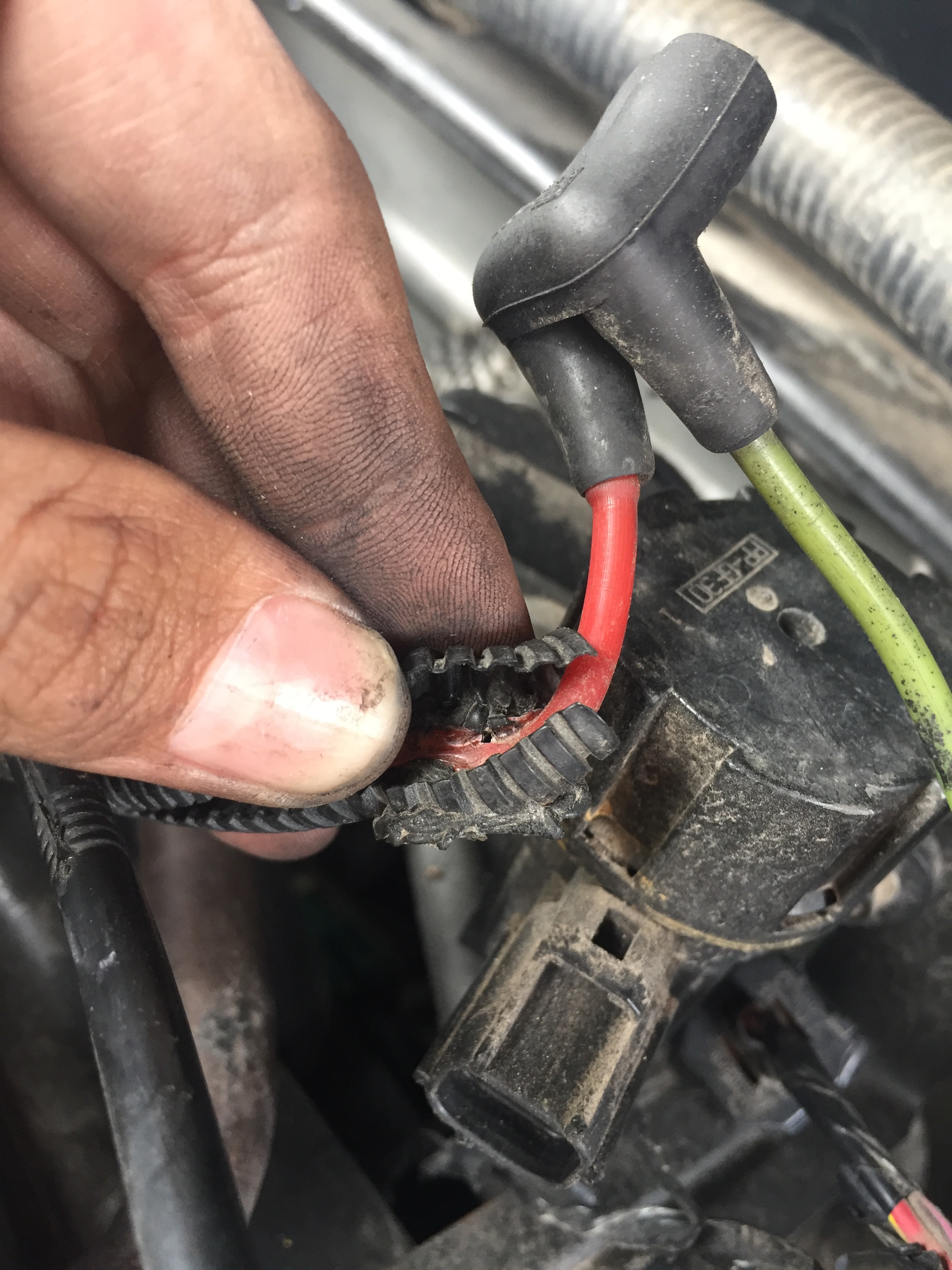

d.garza18
d.garza18
Jun 23, 2017
720
159
TEXAS
found it! I was breaking my neck trying to find a leak on the lines on the passenger side, looked over on the drivers side and found the hose... airs blowing like it should and I’ve accomplished my first heater core and evaporator core job, not to bad overall. Thanks for the help guys!
