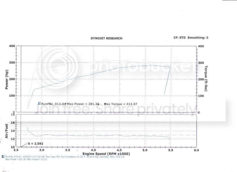

1st my tuner can not get my car to run right with a new tune, he has burnt several chips and the car still has tons of problems with idle etc,One min it ran fine then next min runs like SH*T, He called me to say that I might have a fried computer and I have to put a new computer unit into my car then put in and try my chip in that computer and hope that fixes my problem.
he said the car was going fine on the dyno but I lost tons of power after my cam swap that something is wrong, and My new cam's rpm range is good for 2,200-6,200,But my problem is its only making 281rwhp @ around 5,000 rpm's, my car before was putting down a steady 330-360rwhp, He also noticed my injector wiring is cracked and was touching so he suggested replacing my injector wiring harness, and maybe a better intake that will allow my cam to break into its power band of 6,000+rpms where it needs to be to make my power with that cam.
Do you think my injector wire problem and computer problem is why my car is losing tons of power? he suggested me ditching my upper street heat intake for a track heat and finding a new piggy back injector wiring from a junk yard etc to replace my and install my new computer and a new chip and put it back on the dyno. so where could I find the injector wire harness and how much $ etc??

previous best 2 pulls with smaller cam it put down on a race tune 361rwhp and 320rwtq
on a 93 octane pump tune it made around 330rwhp
Now I put in a new bigger cam and it only put down 281rwhp 313rwtq. and its only making power around 5,000-5,5500 rpms.
The numbers are Horrible!I cant belive that big of a drop in power, the cam should be making power from 5,500-6,200rpms+
I was wondering if the injector wire harness problem and computer could make it run like SH*T yet on the dyno seem fine but only make power @ 5,000 rpms.
Thanks
Jeff
I mean on my stock 130k mile worn out 302 5.0 in my car with the out of the box trick flow heads cam intake on stock compression etc, my car put down 273rwhp and 273rwtq untuned and tune only it put down 300rwhp 310rwtq, now I have a rebuilt 306 with high compression/new pistons, ported trickflow heads and intake, way bigger cam,bigger throttlebody low miles dyno tune etc and it lost tons of power I dont get it and same exact motor / setup just put the new comp cam in and it makes that for power :(
do the 3 problems of the intake,computer and injector harness sound right to it dropping off @ 5,000 rpms and the horrible power loss? even if the same intake on a smaller cam before would pull to 6,000 rpms and ran fine on the old tune? all the problems he told me it had did sound like a computer problem,So i hope the new computer and retune will fix most the problem

there is nothing wrong with that cam...it pulls to 6500 on my hi comp 306 . i think u have another problem... its sound to me like the computer is probably pulling alot of timing out at high rpms and thats why it peaked at 5 grand .... judging bye how much hp u made at 5k u should make about 325 or so at 6k im guessing ..... i love my xe274hr but i would get the next bigger one if i did it over xe282 i think
Thanks! yeah I'm glad to hear that from some 1 else with the same cam,yeah i was guessing 281rwhp @ 5k would be around 320-330rwhp @ 6-6,200. Tommrow my new computer should be coming in so I hope after he puts that in it will run so then I can swap out my upper intake to a track heat and redyno hope it makes power @ 6k, sounds about right and makes sense,wish me luck.

Heres 1 of my new dyno charts with the low numbers :BangHead:

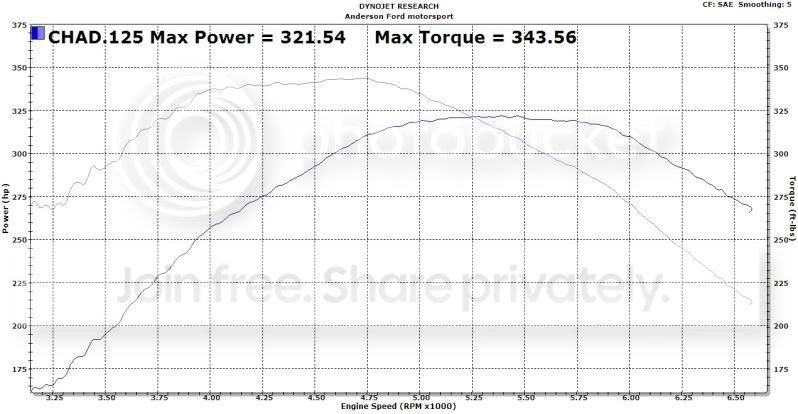

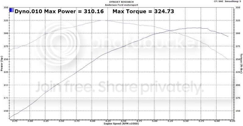

Heres what it should look like if it would make power in the 6,000-6,500 range, these are similar setups with same trick flow heads and same size cams.
