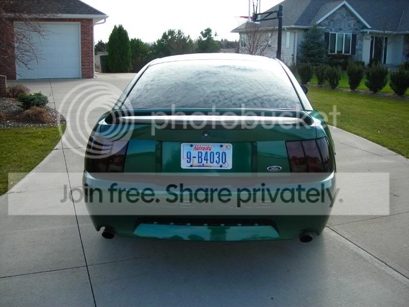

also, thinking about nite-shading my taillights, high brake light. any input? anyone do it and have pics? btw 1997 gt

I just did mine a week ago. I sanded the taillights with 1500 grit first. Then I used 2 coats of night shade and 4 coats of clear coat

I painted these with a mix of black/clear. Like you would use to paint your car. The best way to do it is with a tintable clear but mine worked. Niteshades requires wetsanding and clear IMO.
