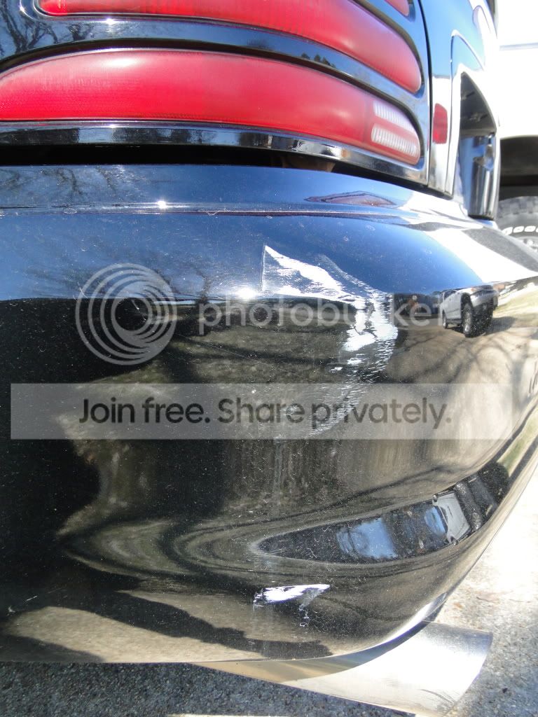

Im not sure where to post this but i fugured the details guy would know...
But i got home today an noticed somebody ran into my bumper an left...there is no dent just scratched it.im wondering what the best way to attept to fix it without getting a new bumper? i havent done anything to it yet.i figured id ask before i did anything that would make it worse
all help/suggestions are greatly appreciated,because im a college student that doesnt want to buy a new bumper

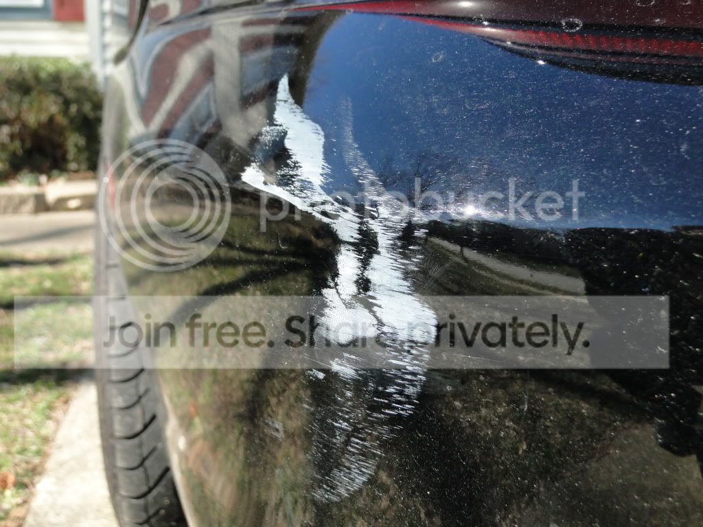

Honestly that doesn't look like it scratched into the paint granted I'm not there to rub my finger over it to get a better idea
It looks like a simple paint swap.....Try buffing it....I bet it comes right off....As a test you could try rubbing your finger over it really fast to see if any of it rolls off

i would try wetsanding it with like 1200 grit first, then polish it back up, looks like some paint transfer, but you didnt lose any paint... you need to just get that stuff off of your paint and polish up.

I had that happen in my wives car when a cement pillar jumped next to me, and rub all over my rear panel. Just a spray and a wash cloth took it right off. I wanna say an orange clean aerosol spray. I will find out from my pops and let you know

i wet sanded with 2000 grit.seems like it took the clear off.not necessarily happy without come but better than the wite on there.i can post pics later.its just dull black in the 2 spots

after the wet sanding, you need to polish it up with a polishing compound and it'll get that dullness out!
not sure what type of polishing compound to use though, wait till someone else chimes in.

it really doesnt even matter, unless you do the whole car, to just get the shine back, use some meguiars, what ever your choice, maybe some fine cut cleaner or swirlx/scratch x.

my cobra had a white brush mark on the rear bumper when i got it......wiped it with a little thinner and then washed and buffed and now ya cant even tell

It doesn't look to bad. Someone who knows what their doing should be able to get it with a rotary buffer.

^i was already doin it when u posted.it a bummer but is better looking then the white paint that was there

Hit it with some rubbing compound now, then a polishing compound, then megs scratch x. then some sealant and wax. should be fine

Bbefore you sand you should of tried a few different things.. Compound, acetone, or a clay bar..Something less abrasive. Now your going to have to have it buffed..GL

Looks like paint transfer to me. A porter cable polisher should be able to take it off with a medium polish. No heavy compound need.
