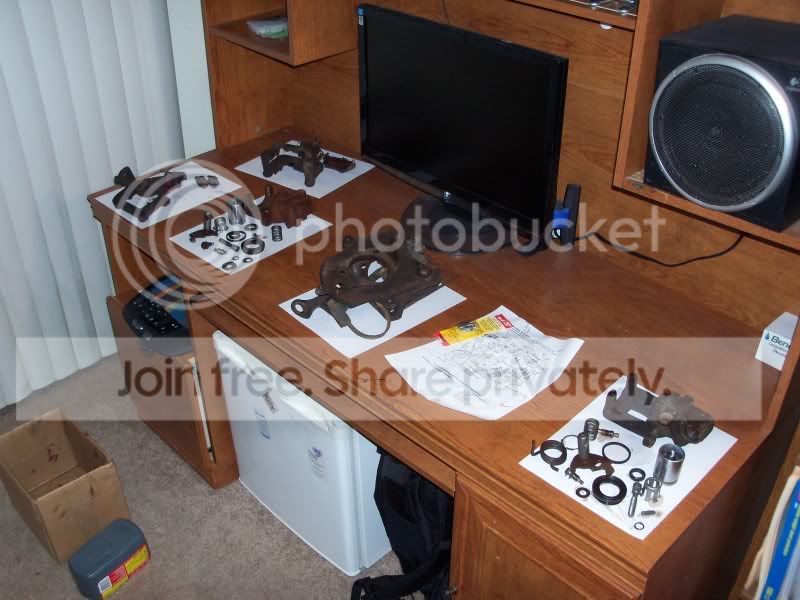

I would prevent sand from getting into the insides as much as possible by taping off the seals/piston area. If sand scratches up the piston bore you're going to have one hell of a leak you'll go crazy finding (and the fluid will ruin your new color).

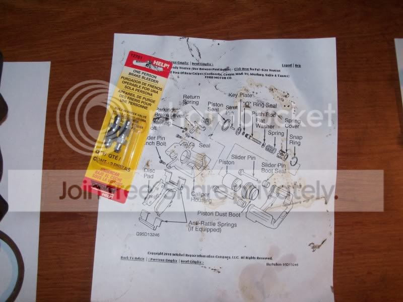

These pictures I took of my dis assembly may help.

Cool thanks so much man! you dont happen to have a dissasembly sheet for the cobra calipers do you? doesnt seem like much to dissasemble. Pull the pistion and the rubber dust boot and maybe a seal down in there? Ive never pulled one apart before so i dont know what im gettin into

Here are all the related pages. Pretty simple. Bleeder, seal, piston, inner seal. Times two.

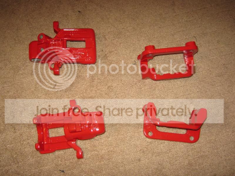

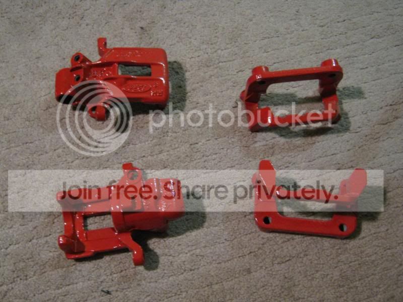

I am going to go pick them up in a few minutes. I had him do generic red that he had left over. I should have some pics up tonight I will try to remember here but you know where my thread is if you don't see them here.

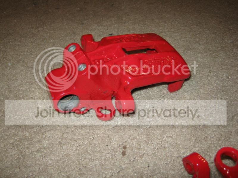

Some things to consider when picking a sandblast/powdercoat...tape off not only the obvious piston boot and the parking brake hole in the backside, but the inside of the two bolt holes for the caliper mounting bracket, the bleeder valve, the parking brake retainer pin, and the inside of where the emergency brake cable slips through...getting powdercoat in any of those will cause you some trouble. I went with the powdercoater I used previously because I just have to drop off the disassembled stuff (sometimes I don't even do that) and he does all the rest from sandblasting to taping off to powdercoat, clear and buffing if necessary, and reassembly where needed. I didn't have to tell him to tape off anywhere I just dropped it off and was on with my day knowing he knows cars and would do it correctly. He did and I'm glad because I often forget how stuff goes back together and I'll miss a hole or two and end up having to clean holes out and retap threads.
