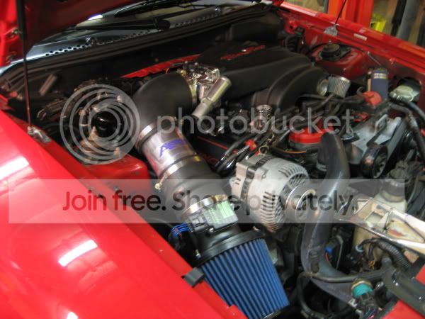

Accufab only makes them for Fox body's but they are awesome pieces. I swaped over to a fox set up just so I could run an Accufab TB, plus the other benifits you get from it.
Venom351R
Mar 8, 2008
5,194
265
Maine
The throttle response is better, I did notice a difference with that and there is not as many bends in the air flow before it makes it to the intake. I like it more just for asthetics alone. Its not recommeded as a power increasing mod even though there is a slight bump in power but its the looks of it and throttle response and less clutter look that made me want to do the swap.

one bend is better then 2 bends, you answered your own question. And there is better throttle response.
I don't feel any lag in my throttle now so I don't see how a fox setup would make it better, plus honestly the fox stuff is a lot uglier than the SN stuff. I always hear it's better for HP and whatever else people say but I don't buy it, I'd think two small bends would be better than one large one. if a car is going around a track its going to maintain a higher speed through two 45 degree turns vs one 90 degree turn.
ivan12
Dec 4, 2007
2,427
40
If you leave the filter in the engine bay then there's only 1 90degree bend, if you have the fox setup and put the filter in the fenderwell then the setup "appears" more restrictive because of the 90degree bends instead of the 45degree in the sn95 setup. I think that's what Scott means
