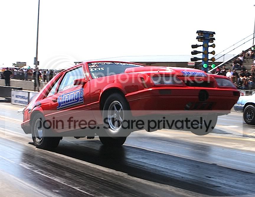

Looks good. You need to get some real tires. Are you on the stock suspension? Before you shift out of first it looks like you front end is getting slammed down before it should. Maybe its just video lag. Im no drag expert but to me it def looks like you might want to invest in a in some suspension goodies. I bet you could drop down into a very low 12 or high 11 if you get your launch figured out. Not really sure what your goals are. What are your 60fts?
B
Bullitt5339
May 30, 2010
396
I have full drag suspension on the car, I just think I had the Strange Adjustables set a little too soft. I was unloading the rear tires, which doesn't help either. I think I may also have too much pinion angle in the car, and it's hitting the tires really hard on the launch, which would unload them.
Right now, I'm really limited by the 555R's. I'm picking up a set of Hoosiers on Friday, and going back to the track on Saturday night with a few small adjustments and the new tires.
My 60ft's on the 555R's are in the mid 1.7's right now. 1.72 being my best, but typically 1.74's. I know with the Hoosiers I can cut that down quite a bit though, along with tightening up the front so it doesn't drop as quick, and possibly softening up the rear so it actually squats.

Once I get some real drag radials on the car, I believe the car will put down 1.5X 60ft times. I found a couple problems with the rear suspension yesterday. The pinion angle was -5* because one of the upper control arms wasn't adjusted correctly and was binding. Got that all fixed, so we'll head back out in a couple weeks and see what the difference is on Hoosiers and with a rear suspension that should actually work now.
I figure when you can do this on drag radials with stock style rear suspension, there's no point in running slicks:
