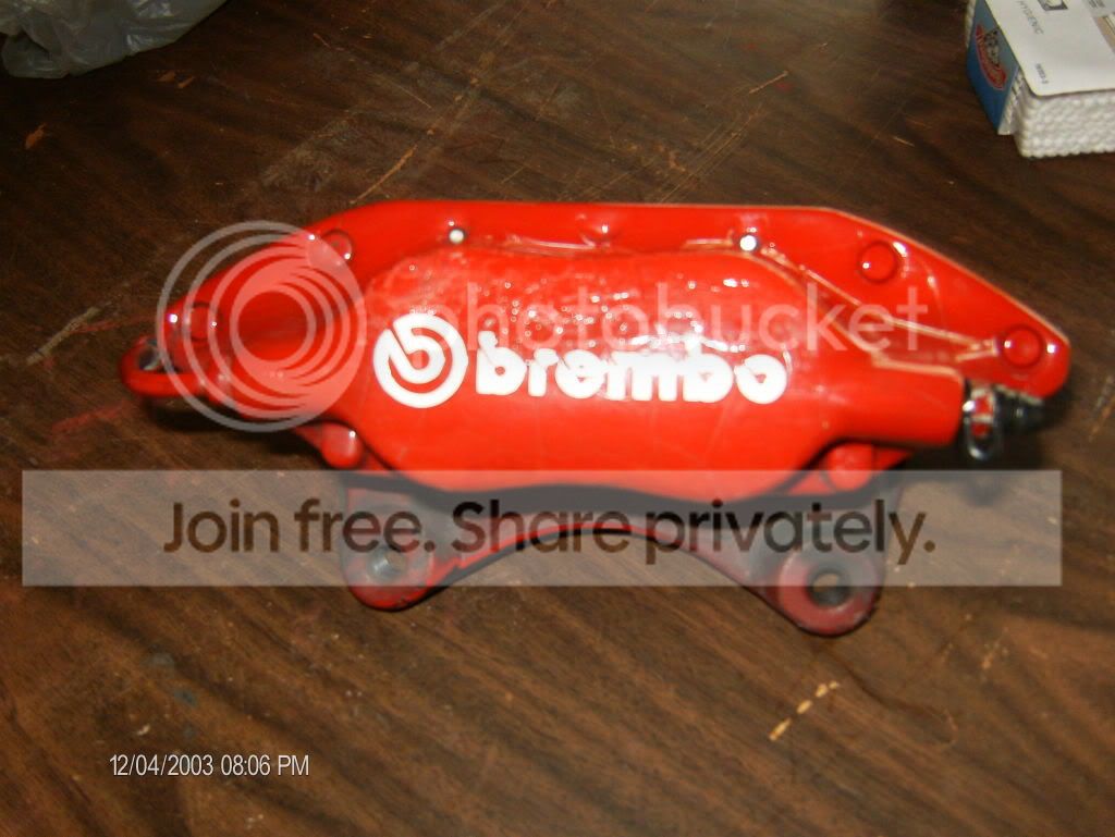

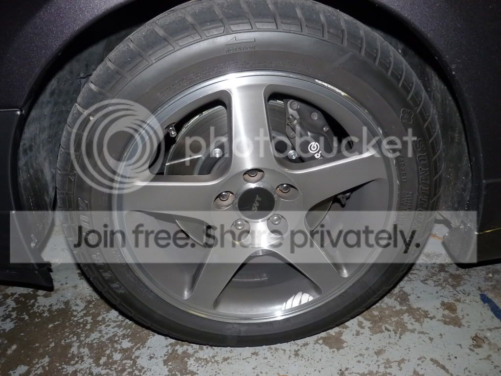

I picked up my used 2000 Cobra R brakes for $600. They were sprayed red and a real mess, but after a couple hours cleaning and painting they came out perfect. The dates on the pictures are way off.
As purchased...
Cleanup..
As installed...
Just saying that you can get a good brake setup for cheap if you are willing to wait for the right seller..
Now I have the two piece rotors and this mess is after one week running track pads on the street.
