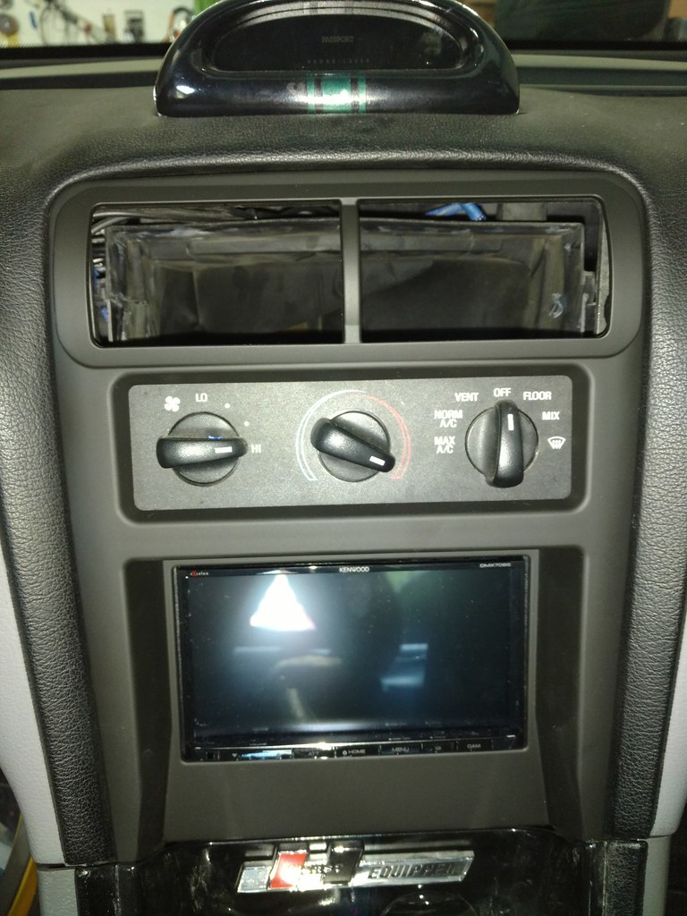

Only complaint here is that the kit is perfectly straight on the top, where the stock kit had a slight curve to it so there is a small gap at the top center, but its not horrible.
So I finally got one of these for my 94 and am a little bothered by how the AC panel lines up. With the 2001+ panels, they were misaligned, but never that bad. Comparing mine with yours, yours seems perfectly aligned with that panel. I don’t understand why mine would differ so much.
I needed the radio brackets, but seeing how badly the metra looks, along with my poor attempt at adding my buttons, I wonder if I could just go back with a 2001, especially since that year has side adjusters for the vents like the 94-00s had.

that is weird. You might be able to make slots out of the mounting holes to allow you to slide it down the little bit it needs
