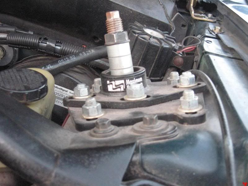

94-5.0GT
Mar 26, 2008
414
javi said:
ReplicaR said:
You have to use on narrow spacer under the plate, and then one narrow and two wide spacers on top.
does the top of the shock hit your hood at all? that looks like it is really high
27,385
51
94-5.0GT said:
javi said:
http://i250.photobucket.com/albums/gg252/slo94gt/94GT/mmazz003.jpg
[IMG]http://i250.photobucket.com/albums/gg252/slo94gt/94GT/mmazz001.jpg
[/quote]
[/quote]
No...
