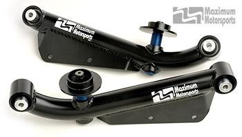

So now I have a question on these, maybe Rich V can answer this one......I cannot decide if I want the ones above with the adjust spring perch or if I want to get the non adjust ones......If I go with the x2 ball joints and bumpsteer kit (which should drop the spindle and thus lower the car in the front) will the adj ones with the spring perch in their lowest setting give the car a even look for both front and rear (like what I have now) or will it keep the rear at the current height. I currently have the UPR upper and lowers, however I want to up grade them to the stronger and lighter MM/Steeda ones. Also will there be any improvement/loss in the handeling/launching abilities that I have right now with this set up. Finally, will the steeda rack bushings help as well? (I have to replace the rack in spring anyhow)

The website say the RLCAs will lower the car an extra 1inch or you can raise it 2 inches.

Perch?? I know these have the mounting flange, what do you mean by perch?
Lol, yeah that is what I meant. Flange/perch, it is all the same

It's my 2 cents but looking at the J&M ones compared to the Maximum Motorsports ones (adjustable ones on both), I personally don't like the construction of the J&M's. The MM's use a solid bent tube with a hole machined through for the adjustable perch sleeve and welded whereas it looks like the J&M's are made from two separate tubes welded to the adjustable perch sleeve and welded.
Sent from Space
That was what I had thought as well. Same exact thought.
Sent from Space
I see your point. Not sure the performance of one vs the other. J&M was actualy founded by some ex MM guys from what I understand. Not sure what or where their designs came from, but again, I see their decals and parts on road race cars. I run their standard LCA in the rear and have been very happy with them.
Sent from Space
That is what I was thinking. That is part of the reason why I want to replace the UPR uca and lcas on my car.....I am afraid that as the power goes up, they will fail quicker.
Same, just basing my opinion off the visual of both. Have no solid evidence to back my statement although it would be fun to test!
