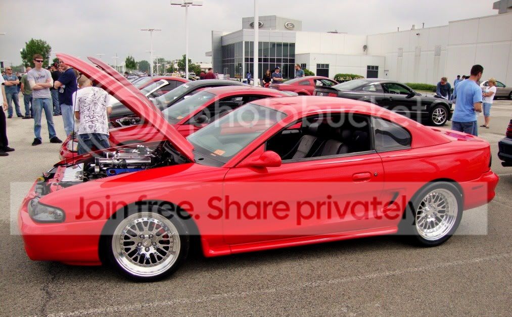

18x11 with 335/30/18 hoosier drag radials

Those are tight with the fender. I'm sure with smaller tires it would fit better.
He also doesn't have exhaust running beside the inside....
Looks amazing though!

I don't love it from a performance aspect. that 335 is going to roll over bad on an 11" wheel... but as far as the look goes I guess it's alright.
95opal
Jun 21, 2007
3,032
1,619
like brett said the 11" wheel is to small for that tire. Should be on an 11.5 -12.5 rim and yeah you wont be able to fit tails in there unless your going custom.
