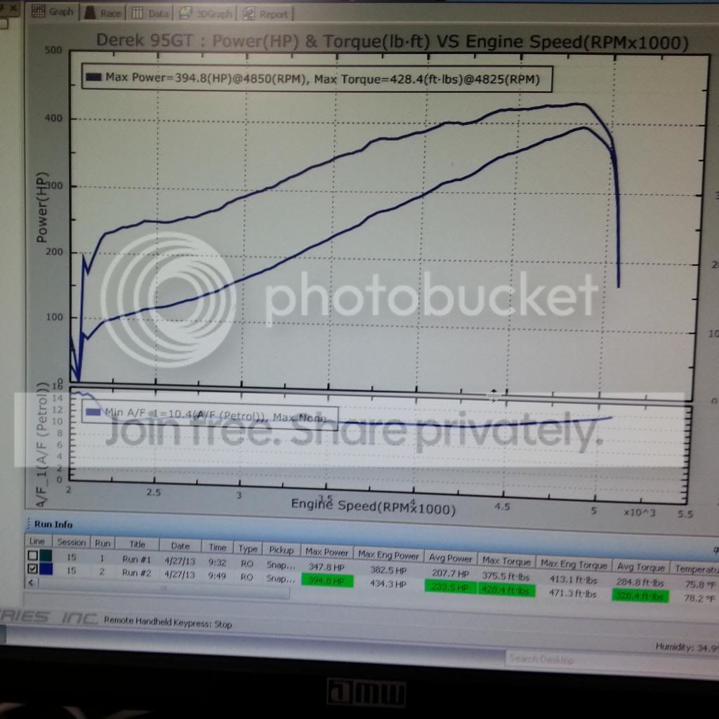

Well car ran out of fuel pressure at only 4800 rpms .. The tuner says Im pretty much ****ed because the car is going to make well over what my 42lb injectors can handle so after my car is done getting painted all go through the fuel system and get everything working and Im not going to install a bigger supercharger pulley Im going to stay with the 3.33 and if it makes 13psi o well..
Keep in mind it made this power at only 12 degrees of total timing also lol lol .. Cars going to make well over 500 rwhp its hasnt even seen its peak tq yet..
here is the dyno run and you can see it made 10psi and we shut it down at 4800rpm

Well, you really don't want to push a whole lot more out of a stock bottom end anyway.
Just the added RPM once you figure out the fuel will bump the power in the danger zone for a factory 5.0 block.
It has to be some kind of obstruction in the fuel system. Clogged filter, maybe a pinched line, that's what I'd start looking for. What 255 pump do you have? Is it a high pressure 255?

i won't put a bigger a pulley on there. lot of guys are making 500rwhp without problems. will it last forever? probably not, but you already have a boss sitting around so what does it matter. figure out why you're loosing fuel pressure on the top end and enjoy the car. and i'm sure you know, but there is no correlation between pulley size and max boost. boost is only a measure of restriction.

I've used the GSS340 Walbro in a few cars with good luck, it's a high pressure pump. Said to be better for boosted EFI applications, should support your HP level no problem.
But yea, I'd look for kinked lines or something obvious 1st.

Yea I understand what boost is but I dont want to have to buy new injectors and re tune my car again lol .. I want to keep the 42lb injectors and thats where the problem is ... The car is going to make more power then injectors can take and if the car is making that at only 12degrees of timing its going to be well over 500rwhp with 15 or more degrees of timing so im trying to work it were the car makes closer to 460rwhp were the injectors are not riding on the edge..

2.95" pulley and i can't say i really look at the boost gauge and notice how much i hit up in the RPMs. i've seen it hit 11lbs at one point but that was with my old edelbrock heads. The AFRs, i don't know. As far as timing, not sure how you mean max timing. I set the base timing to 10* and then use my PMS to adjust it accordingly. haven't really retuned it yet with the AFRs. it pulls decently with a good A/F until about 4k then just makes noise. i need to add more timing up top.

You have QH catalog and see the injec duty cycle.. You'll know if your maxed out.. You prob need atleast the high press 255. Buy i would go with the 340lph. Especially since your going to upgrade to the boss block..

Sounds like you need more fuel...BAP maybe?
I had issues with my car running out of fuel around 400 rwhp with a 255/42 lbers...my tuner always said I just had bad lucky and that my stock fuel lines were probably the issue.
Either way, wouldnt fuel pressure dropping mean your pump isnt keeping up?

Look let me explain this for people lol .. 42lb injectors are good for 450rwhp to 470rwhp max .. my car is making 400rwhp and 430tq at only 4800 rpm so the problem is with the 3.33 pulley im making way to much boost and need a bigger pulley to lower boost because thr car will make well over 500rwhp..
