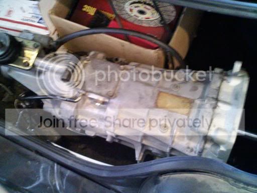

a little bit about this car. the drive train came from my friends 94gt he totaled it into a tree. we gutted that thing and put it all into a 95 v6. the motor is out of an lx fox its a 306 e303 cam 1.7 roller rockers. victor jr heads powerdyne running 11psi for now. it has 4.10 rear end gears. a t56 6 speed with 0.50 overdrive front mount intercooler bov and bypass valve (we havent figured out what one will work best for the blower) 42# injectors, ported gt40 lower intake, downs box upper, fox throttle body swap, valve train gurdle, main cap gurdle, high volume oil pump and some more crap i cant remember.
custom bellhousing
this thing should move, but it seems like its taking forever to put back together. its ran with 3 differnt combos this is the newest of them. my friend that owns it is looking into a paxton or vortec. then he will kick me down the powerdyne for cheap since i've done a lot of the work on his car.
