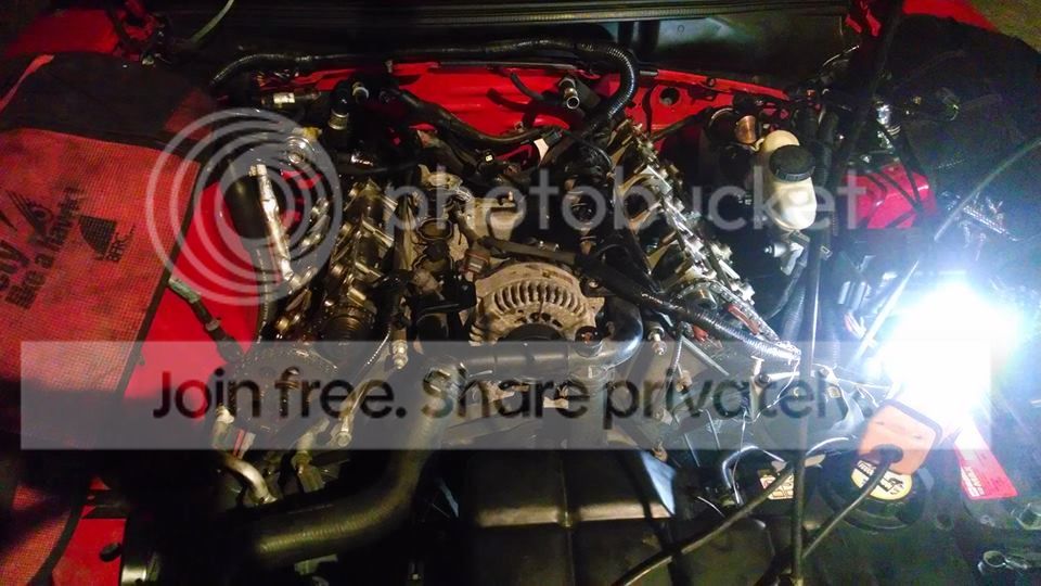

All In all it was a very easy swap. so easy I couldn't believe it. once you figure out how to get the booster and master cylinder out (6 bolts, one clip and a book of cuss words later) the drivers side cover slips right out.
I actually had to do it twice, one last night and one today, because I was a tooth off. Woops. luckily to valve damage in my case.
My only complaint is I didn;t get to use my adjustable gears. one of them cracked upon torquing the cam bolt. how? who knows. bad heat treating/forging..dunno. after I got it back together and test drove it I immediately felt the power increase. I was honestly amazed. it feels like going from a stock NPI to a geared and PI 2v.. it's kinda shocking. TOTALLY worth the 8 hours to swap them out (if your slow) If your really interested in doing the swap I'll give you my number and walk you through it, Very easy. I was honestly a little intimidated by the timing but after reading through the ford manual a couple times I couldn't believe how idiot proof these motors are!
