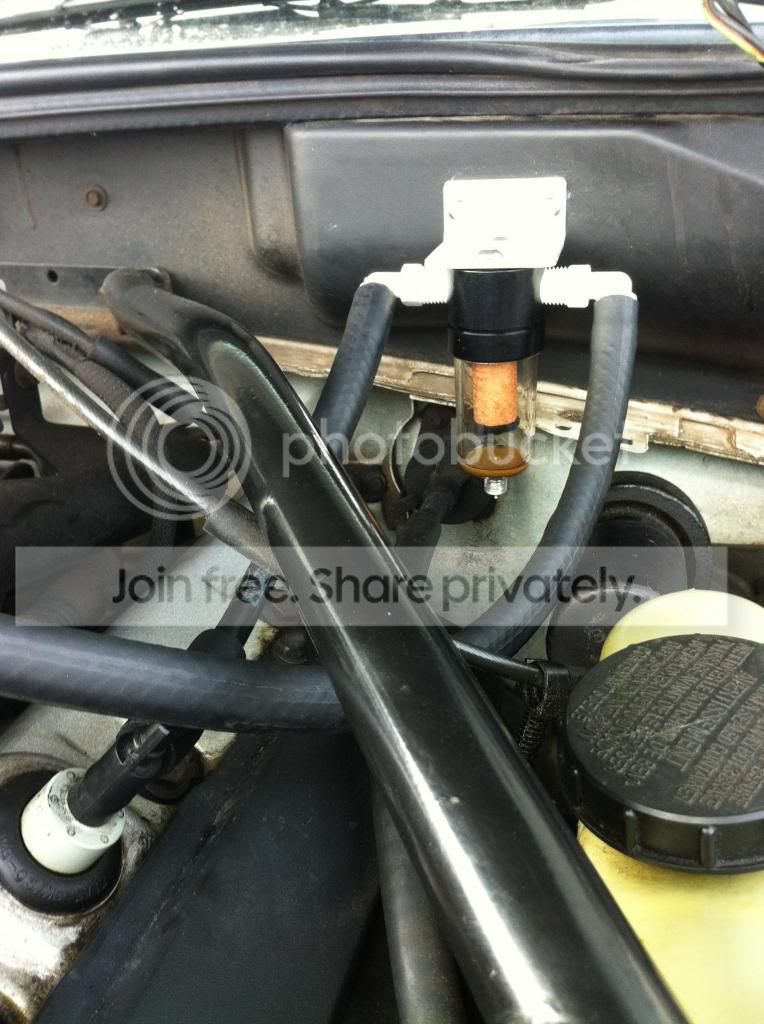

I had to install an in-line filter as well years ago. I can see how much oil vapor condensation collects in my single port 3.8. Seafoaming by sucking it in through the pcv line is my method. One can in gas tank, one can to pull into upper intake manifold. It works so F'n great. My copper plugs have been lasting long intervals. Good link-

Installed one of these- Helps keep intake much cleaner for sure.

I've had this on my SVO for years, got it from Home Depot. Keeps oil out of the throttle body, vam and the turbo

get one from home depot. they are off of air compressors.... they are like $15.00... i was pissed to find that out after i bought steeda's $80.00 unit.
plus steeda's broke on me and they refused to replace it.... i hate steeda. what a bunch of ass-wipes.
A MUST HAVE-
