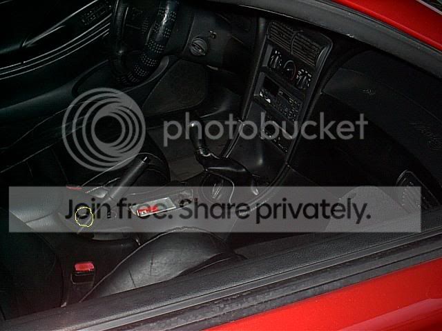

my 97 has a ash tray. Just for reference of this thread since 1 person wasn't sure.
my pic:
