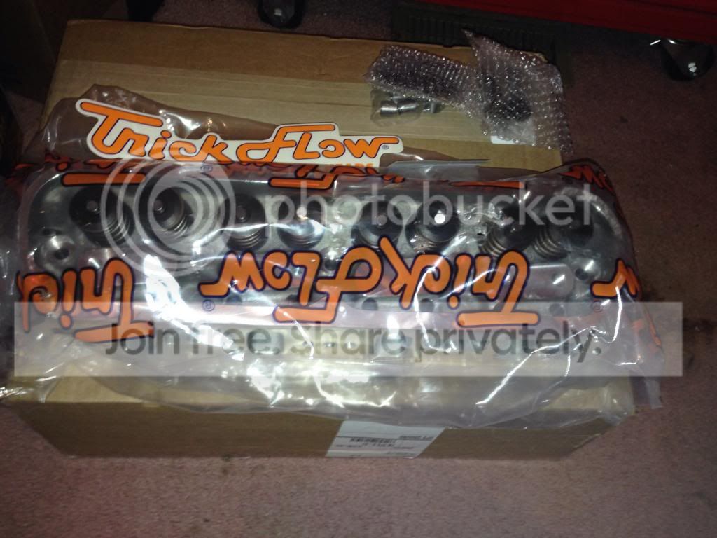

Finally got y'all some pics of the stuff I've bought .

Tuesday new head gaskets will be here finally and Monday the new pushrods and oil and valve cover breathers etc. Trickflow head gaskets were 79 each ! Going to start assembling it some possibly tomorrow and Monday and Tuesday going to put the new heads on .

New Trickflow Heads , New Harland Sharp Roller rockers , New Comp Cams hardened pushrods , ARP hardware , New Pyles polished stainless steel headers , New 4" polished aluminum valve covers , New MLS head gaskets .
