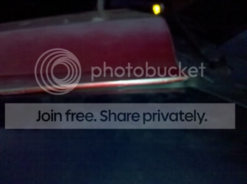

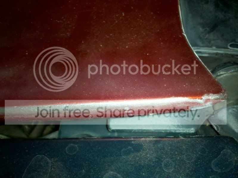

This is my new hood I just got, Ya it needssome paint no biggie but the hood sits really high on the hingess, is there a way to get the hood to come down.

Which holes in the hinges did you use to secure it? You should have used the smaller of the holes on each side, putting it on the larger
of the two can make it stick up.

something def doesn't look right there, just curious what brand hood. cervinis?

Looks as if your old hood sat up the same as the new one on the passenger side. Sure your hinge isnt bent in some way?
