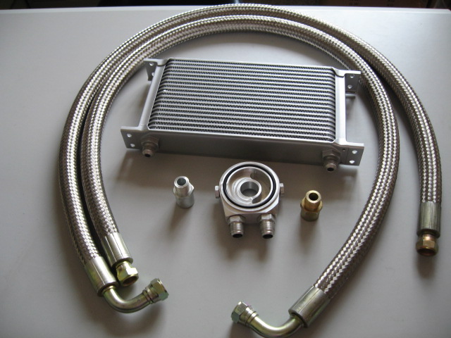

Should be something like this.. Just like the 4.6
I am not really all that worried about the sandwich plate just curious if they set the cooler up in front of the radiator or if there was a different and better place.
