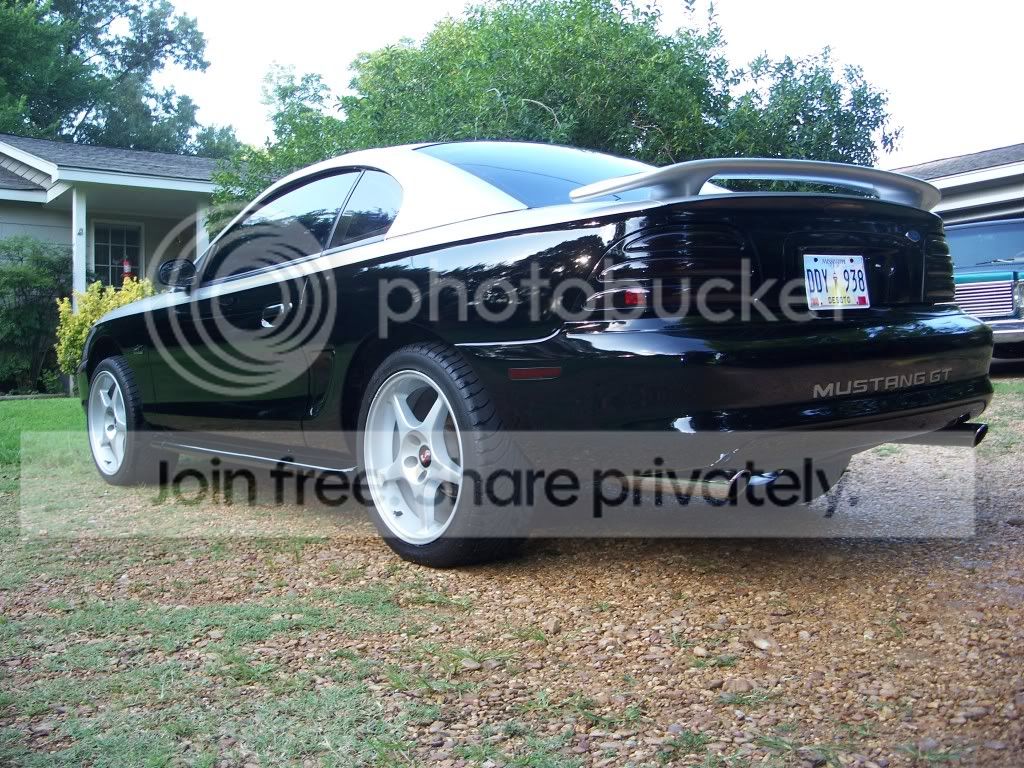

I had mine done when they painted my entire car. I've seen where guys have masked off the valance part like with newspapers, let me see if I can find it.
