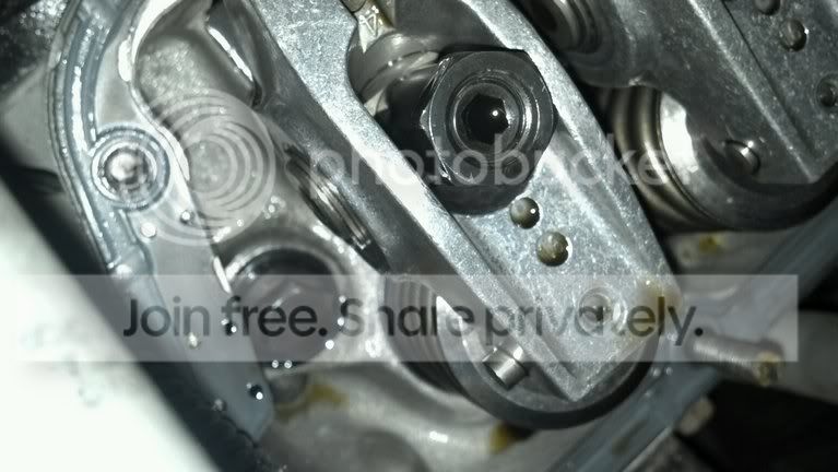

hey guys ive been having alot of valvetrain noise latley and new my my valves needed adjusting, but then i started getting a louder ticking noise and when i pulled the valve cover tonight i found the pin in the tip of the rocker arm had walked out, luckley not all the way, ive already pull the rocker arm off the car and tapped the pin back in but im not sure if i trust it now. Can anyone tell me what arms these are? theres not markings on them at all beside the ratio
http://i99.photobucket.com/albums/l311/BoostedSVTfocus/photobucket-636-1331170837413.jpg
http://i99.photobucket.com/albums/l311/BoostedSVTfocus/photobucket-2466-1331170749794.jpg

I do not know the rockers though

They kinda look like the Crane energizers but Im almost positive theyre Pro Form. The FRPP's have a Ford oval on them (I have them in my GT40s)
If thats the case, GET THEM OUT OF THAT MOTOR!!!! Just google proform rockers and read the horror stories.

I am pretty sure those are not Energizers.
The only reason I say that is that EVERY set of Energizer rockers and I have seen a good amount both from a 93-95 Cobra as well as straight from Crane have the Crane Cams logo printed on the top of the rocker.
IMO, that looks like a Comp Cams High Energy Die Cast Rocker. Plus, look at the oil passages.
