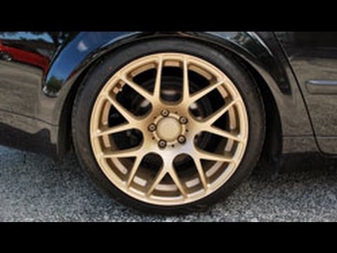

I really like the look of bronze/gold fr wheels with a chrome lip on a black car. Is there any way I can make this happen? I heard it's extremely difficult to strip chrome. I was thinking for a test run plasti dipping the centers then painting gold over the plasti dip that way I can peel it off but I don't know if that's even possible. This is the look I want to try to get

You can use a black plasti-dip as a base coat and use their gold metallic dip over it. The more coats the brighter.
From there you can see if you actually like it and can consider getting them professionally powdercoated.
And yes, you can paint chrome wheels.
if you paint over plastidip you'll lose the ability to peel it easily when you want to remove it. I'd suggest the vintage gold plastidip, it covers a lot better than the gold metalizer and will give you a more consistent color. just note you'll need to peel the tape before the final wet coat of dip dries, otherwise you won't get a clean edge.
