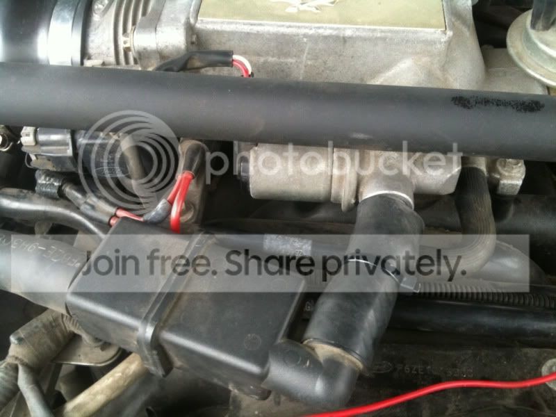

ok well i went cheap and bought a 1/2 copper cap from home depot for .74 cents, and drilled a 1/4 inch hole through the center. I then took off the hose and placed it inside and viola done. Ill post up pics if you still want them

Hope the pics arent too big n yes car is dirty its a DD. I also ran a zip tie over it cuz i didnt like the play.

Helps with hanging idle, the RPMs wont stay high when you left off the gas and will instead drop normally

Drove it earlier and it was raining so I was easy on her, but this afternoon it was warmer so I gave her a little gas and after downshifting the exhaust rap is a little excessive so im goin to open up the 1/4 hole a little.
